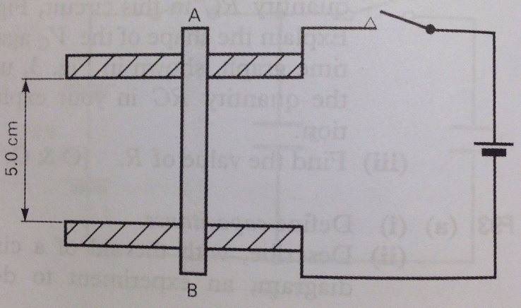

The diagram represents a cylindrical aluminium bar AB resting on two horizontal aluminium rails which can be connected to a battery to drive a current through AB. A magnetic field, of flux density 0.10 T, acts perpendicularly to the paper and into it. In which direction will AB move if the current flows from A to B?
Calculate the angle to the horizontal to which the rails must be tilted to keep AB stationary if its mass is 5.0 g, the current in it is 4.0 A and the direction of the field remains unchanged.
(Acceleration of free fall, g = 10 m s-2.)
Answer: 21.8 °

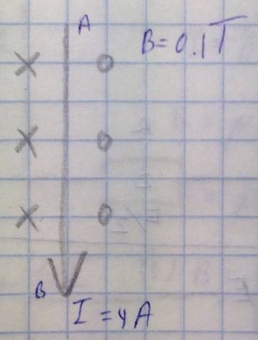

"In which direction will AB move?"
Is this question asking about the direction of the force? If yes, what direction of field should be taken? On the left side the field is directed towards the paper (since current goes from A to B) and on the right side the current goes out of the paper.
I tried to calculate the angle but I didn't get the correct answer.

What's missing?
It's the external field that you need to consider (which is given as into the paper), not the field created by the current-carrying wire.

But how do we find the force direction? We have a bar with current pointed downwards. If we grab the bar the field will enter into paper at the left side and go out of paper at the right side.
You are still focused on the field created by the current. But we don't care about that field!
In your diagram, the field of interest is uniform and points into the page. That's the 0.10 T field given in the problem statement. (It's not the field due to the current in the wire.)
To find the direction of the magnetic force on that current you must use a right hand rule. ##\vec{F} = \vec{I}L \times \vec{B}##
We found F = 0.02 N, which is the force to the right. Now we need the force downwards: F = m g = 5 / 1000 * 10 = 0.05 N.
tan α = 0.02 / 0.05 → α = 21.8 °. This is the angle of the triangle of the two forces (weight force and the movement to the right force). And so we need to tilt the bar to the left on 21.8 ° to stop the bar from moving to the right.
I think this should be correct.

I would have done it by treating it just like a box on an incline. There is a component of weight acting down the incline (mg sinα) and a component of the magnetic force acting up the incline (F cosα, where F is the magnetic force already calculated). Set them equal and solve for α.
But your method is fine, as long as you're clear on it.
