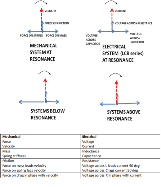

I have tried to illustrate the similarities between mechanical and electrical resonators. It might make it easier. The electrical circuit is an LCR series circuit and for the mechanical system I have assumed a spring and a mass. In both cases the drive power is kept the same as frequency is varied. All the drive power is absorbed in friction (mechanical) or resistance (electrical) once steady state conditions are reached. These are only analogies and other comparisons are possible.

sophiecentaur said:
There's a reasonably intuitive way of thinking about the phase of a driven oscillator (mass on spring). When the natural frequency is equal to the driving frequency, there is a 90° phase difference between the two oscillations. If the mass is lighter, its motion will 'follow' the driving frequency easier so you can look at the phase shift as being less. If the mass is greater then it will lag behind because it never quite makes it to the 90° phase point.
Of course, Barton's Pendulum is one stage harder than this because the pendulums all have different frequencies (there's not a particular 'driving' frequency. The shorter ones will be racing ahead of the rest and the longer ones will be lagging behind. It's a case of Coupled Pendulums, rather than Driven Pendulums.
Actually, that's not quite right. The middle pendulum has a heavy mass on it and the others are light. The middle pendulum can be regarded as the 'driver' and the others as 'driven'.
I agree that the Maths may be easier (more familiar) perhaps for someone happy with EE but it is much easier to produce a row of coupled pendulums than a row of coupled electrical oscillators. The concepts of Electrical Impedance and Reactance are things that we EE's took in with our Mother's milk but I do wonder about how 'intuitive' those concepts are. The left hand side of your table would actually be enough, I feel. (It's nicely put, too)
