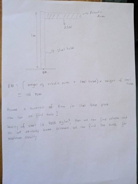

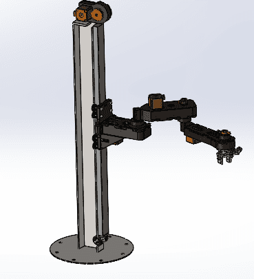

I wanted to size the circular base at the bottom for maximum stability so the the whole system doesn't topple over and fall when robotic arm is under operation.
i tried many methods but i am not convinced with the results and equations i am trying.
Bending moment = (Weight of steel tube + weight of robotic arm) x Height of steel tube
Or maybe Stability factor = 2

Assuming the base will be anchored with eight peripheral bolts.
I think you need four triangular gusset plates between the column and the circular base.
Hello friend, it is already in the original 3d model. I'm just having a hard time sizing the base.
I did consider triangular gusset plates initially but due to the functionality of the robotic arm it won't be possible. So it was decided to design a base which will be clamped onto the floor with bolts

The bending moment at the I-beam weld to the base should not include the height of the column (except for accidental and any dynamic horizontal loads), only the weight and load of the arm and its horizontal distance to the center of the base.
It seems to be a little moment based on the represented 25 Newtons.

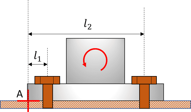

Assume elastic deformation of the bolts in this figure to balance the applied moment ##M## from the load, about the tipping point ##A##. What do you find?
Likes Juanda

Slow down a bit. Your bolts are not all equidistant from an axis passing through the tipping point. Show me the equation for the sum of the moments in just the simplified diagram I presented. Just two bolts for now to wrap your head around what I'm talking about.
Sum of moments = F x (L1 + L2)
No (that's not quite correct), the forces developed in each bolt are different.
Hint: You aren't going to be able to solve anything just yet ( too many variables, not enough equations at the moment), we are just writing down the base equation to work with.

I think maybe i'm getting what you are trying to do. It is to balance sum of moments of all bolts with the bending moment at the bottom due to the robotic arm?
if yes, then what next?
Then you let the bolts deflect some small amount ##\delta_i## assuming the plate stays "straight-rigid member" as it "tips". Relate the deflection of bolt ##l_1## to the deflection of the bolt at ##l_2## using that geometry and the force ##F_1## to the force ##F_2## via the elastic equations for each bolt.
Likes Juanda
How will I find the base size and mass from your explanations?
Are you going to make the base so massive that you don’t need to bolt it to the floor, or are you going to make it strong enough to withstand the loads acting on it and let the bolts hold it to the floor? There is no “right”answer IMO. It’s something you need to “think” about. What I am trying to show you is how to calculate the stress in the bolt from the loading on the base. Which in turn is a loading on the base. Your job would then be to the make sure the base is strong enough to remain effectively rigid under said loading. Others mentioned gussets, and the floor, etc…all these things must be given some careful thought. I’m afraid formula grabbing your way through this is not going to work out so well.
Likes Lnewqban
  • #31
I was going to consider both case. You think an advanced fea simulation is the way to go?
  • #32
First figure out why you may wish to choose one base over another. If you aren't bolting it down then the base needs massive enough (and/or with some footprint) so the robot doesn't tip during its maneuvers. You can solve that problem with Dynamics. If you want a lighter weight solution that doesn't need to be "moved" you can focus on designing the bracket, bolts, and substrate.
