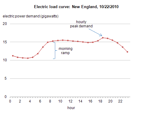

Necessary? As long as the supply curve matches the demand curve, it doesn't matter how you achieve it.
Here's a curve for a particular day I found via google:
And explanation:
https://www.eia.gov/todayinenergy/detail.php?id=830
There's an infinite number of production mixes that can match that curve. But for that particular curve:
  1. An all solar grid would need something like 52 GW of capacity and 234 GWh of storage to match it.
  2. An all nuclear grid would need around 13 GW of capacity and 36 GWh of storage to match it.
  3. A 10 GW nuclear and the rest solar grid would need around 12 GW of solar and 54 GWh of storage to match it.
Both Options 2 and 3, using baseload nuclear, require less storage than an all solar grid. If that curve hasn't changed then I don't see how the utility of baseload power has changed. IMO, saying the concept of baseload is "outdated" is a political statement that ignores the actual shape of the demand curve, hoping to score points for intermittent renewables at the expense of traditional baseload sources like nuclear power.
  1. An all solar grid would need something like 60 GW of capacity and 180 GWh of storage to match it.
  2. An all nuclear grid would need around 13 GW of capacity and 50 GWh of storage to match it.
  3. A 10 GW nuclear and the rest solar grid would need around 20 GW of solar and 60 GWh of storage to match it.
I don’t know the answers to the following two questions:
Would you mind explaining how did you estimate those values?
Also, when we talk about storing huge amounts of energy during low demand periods of time, what is modernly used, other that reversed hydroelectric storage?
Sure:
  • The minimum demand is just over 10 GW, so that's where I drew the line for baseload.
  • I estimated the curve above 10 GW to average about 3 GW (13 GW overall average).
  • I used a simplistic 25% solar capacity factor (er; 13/.25 = 52, not 60) and an all-or-nothing 6 hours of production. I see a math error, though, in the storage; using percent instead of hours. Using the 13 GW and 18 hours of storage = 234 GWH.
  • Similar issue on nuclear storage: if we're charging at 2 GW for 18hrs that's 36 GWH.
  • And similar issue on scenario 3. 3 GW average production over 24hrs is 72 GWH, producing it in 6 hrs is 12 GW.
I've updated the numbers.

I always thought "baseload" and "minimum demand" were the same thing. That is, "baseload" is a characteristic of the demand, not a characteristic of the generation source(s). Maybe I have always been wrong, or maybe the definition is evolving.
Likes bhobba and russ_watters
That is correct. Baseload is best described as the minimum demand.
