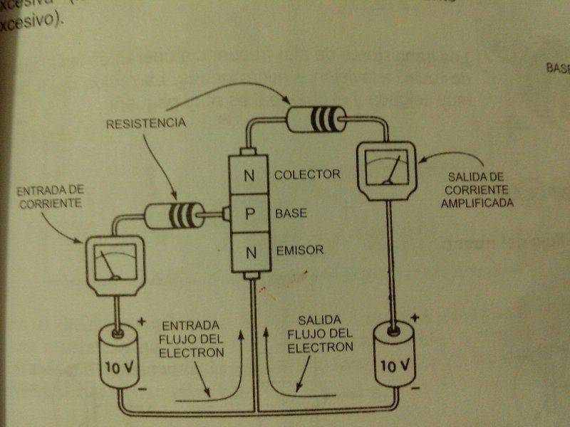

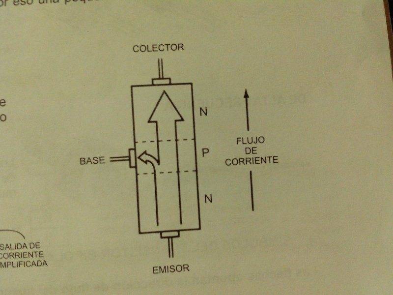

In summary, the textbook says current flows from the emitter to the base and then to the collector, but the drawing seems to say that it should go in the opposite direction. The text also says that two resistors are used to prevent the transistor from overheating, but the current is flowing first to the transistor and then to the resistor, which is not what the drawing says.
thegreengineer
54
So, recently I started learning about electronic components and then I started learning about semiconductors. The one which I've been having some real trouble to understand its function is the transistor.
So I bought an electronics textbook called El ABC de La Electrónica (The ABC of Electronics in Spanish) to check how it actually works; as well to learn more about electronics.
My doubt focuses on a couple of drawings of how a NPN transistor (BJT type) works:

This drawing basically represents the how electric current would travel across the transistor if this were connected to two 10 V batteries, however I got confused on this because how does current flow from the emitter (emisor) to the base and at the same time how does it flow from the emitter to the collector? Also the text says that two resistors were used to prevent the transistor from overheating but the current is flowing first to the transistor and then to the resistor according to what the drawing says; or should it be in the other way otherwise? I need to solve this doubt because I really want to learn electronics and if I don't learn how to properly use the transistor then I won't be able to make proper circuits.
Where do you see a problem here?
If you want to limit currents, the order does not matter. In a circle, current flow is the same everywhere. In this setup, the order matters a bit because a resistor directly at the emitter would influence both current circles.
