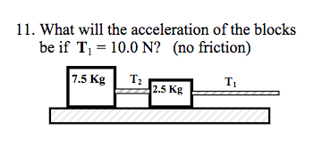

I am taking physics (freshman, high school) and I am very confused on the current topic. We are learning about Newton's first, second and third laws. Our teacher speaks very fast and I cannot seem to understand many topics that he talks about.
Questions I am confused on:
1. A plane is moving in a constant velocity. The air drag of the plane is 1800N. What is the net force?
2. My second question is an attached file.
If you have the time and you are solving this, please write out each step carefully when solving. I am completely lost. If you have the time, THANK YOU SO MUCH!

Could anyone help with the second question?
Do you know how to draw Free Body Diagrams?
Do you understand what is meant by a system?
You are free to choose what assemblage of bodies constitutes a system. Typically you want them such that every mass in the system has the same acceleration. You can then ignore forces between parts of the system and just look at external forces which act on the system as a whole, and apply Fnet=ma to this.
In problem 2, you can treat each block as a system and draw the FBD for it. There is an alternative. Either will work.

freebody diagram, kinda. is it where you draw a cartesian plane then draw arrows in different directions?
so what you mean is that i could solve this as one, or split it into two?

You draw one rigid body and show all the forces that act on it. Do not show the reaction forces it exerts on other bodies - those would be shown on the FBDs for those bodies.
When you have that, you can write down the ΣF=ma equation(s) for the body.
That is the easiest way in this problem. The two blocks will clearly move as one, so treat them as a single rigid body.
I would guess that the question goes on to ask about the tension on the string connecting them. If so, you will need to consider one block in isolation.

The tension of a rope is the always the same on any side of a rope, right? Why is that?
Apply ΣF=ma to the rope. If the rope is being pulled with different forces at each end and the rope is massless, what do you conclude?

Oh, right. So NetF is 0. Which means that on each side it is pulling the exact same? Does that have to do with Newton's third law?
Second and third.
The third law tells you that the force the rope exerts on the object at one end equals the force the object exerts on it.
The second (combined with the zero mass) tells you that the forces exerted on the two ends are equal and opposite.
Tension is not exactly a force, more like a pair of equal and opposite forces.
Note that the tension is not uniform if the rope has mass and is accelerating.
haruspex said:
Second and third.
Okay, so that means T1 is the same as T2.
No, we were discussing the forces associated with one rope. T1 and T2 are the tensions in two different ropes.
The problem doesn't actually ask you for T2 and you don't need to calculate it. Perhaps return to that after answering the question?
