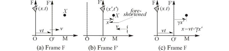

Thanks. The "From physical principles. Time dilation and length contraction" is evidently the bit I want.
Observer F sees the point X as (x,t), Fig,(a). F' sees it as (x',t'), Fig,(b). But due to foreshortening, a length x' in frame F' corresponds to γx' in frame F, Fig.(c). Giving x=vt+γx', and not the Wiki value x=vt+x'/γ: And I don't see the time a light photon takes to get from the event to an observer considered.
Wiki is correct on that first point.
The time it takes a light signal (or a sound signal, or a telegram) to get to the origin of the coordinate system is irrelevant. The event could take place in a closed room from which no light escapes, but it would still have coodinates ##(t', x')##.
The "eye" on the y-axis is misleading. If I did those digrams I would have the eye at the point of the event. That's where the local observation is made or recorded.
Except that length contraction, like time dilation, is symmetrical: A distance the measures ##\Delta{L}## in frame F will measure ##\Delta{L}/\gamma## in in frame F' but also a distance the measures ##\Delta{L}## in frame F' will measure ##\Delta{L}/\gamma## in in frame F - not ##\gamma\Delta{L}##.
Relativity of simultaneity is at work here, in a rather unobvious way. Are the vertical lines representing the T axes the same lines in diagrams (a) and (b)? In frame F the distance between O and O' is ##vt##, and in frame F' the distance between O and O' is ##vt'##, but ##t## and ##t'## are not equal.

It diverges where Wiki gets x=vt+x'/γ and I get x=vt+γx'. Lengths are contracted in the moving F frame that F' sees (Fig.(b)). The F-frame correlate of x' (Fig.(c)) must therefore be greater than the F' value. Meaning that the Lorentz factor γ (always >1) must be in the numerator (where I put it) and not in the denominator (where Wiki puts it).
It depends on which frame you are in. ##x'## is a length in primed frame: the distance from the origin of the primed frame to the event. This distance is contracted when measured in the unprimed frame.
Again, imagine a stick of length ##x'## from the origin to the event. You want to dilate that stick in the unprimed frame to a length of ##\gamma x'##. That would be length dilation.
And you have it wrong. As we pointed out above, length contraction is symmetrical and you have fallen into a somewhat unobvious relativity of simultaneity trap.
You could take advantage of the fact that you know that the Lorentz transforms are correct even though you cannot (yet) derive them, and use them to transform all of the relevant events, and you'll likely see the error in your analysis.
We are talking about observers perceiving events in their reference frames. Distant events are perceived later than corresponding close events.
No, no, no, no, no, no, no!
We are talking about events as measured in a reference frame.
The speed of signals has nothing to do with this. When the Titanic sank, no one in London knew until the next day. But, that doesn't mean that the ship sank a day later in a London reference frame.
And, certainly,no one in London actually saw it sink.
PeroK said:
It depends on which frame you are in. x′x′x' is a length in primed frame: the distance from the origin of the primed frame to the event. This distance is contracted when measured in the unprimed frame.
This is the crux of it. Unprimed distances move, and are contracted, in the primed frame (Fig.(b)). And not in the unprimed frame as you maintain.
Explain. Does light not have a finite velocity?
It also has had. Einstein was not the first to discover that. Why light? Bats navigate by echo location. So, does SR for bats need to take the speed of sound into account?
PeroK said:
The Lorentz Transformation is not about observers but about reference frames.
Is not a reference frame the viewpoint of an observer?
  • #31
Because relativity assumes you correct for light travel time when determining when something happened. Otherwise there's no reference frame - two people at relative rest but not in the same place would assign different coordinates to events.
You are also treating the time coordinate differently from the spatial one. You add on the travel time of light to the time coordinate, but not the travel distance to the spatial coordinate. You shouldn't do either, I hasten to add, but you might like to reflect on why you're doing one and not the other.
  • #32
No. It's the combined viewpoint of an infinite array of observers filling spacetime. Alternatively, it's one observer who carefully corrects for light travel time, so the observer's location is not involved in the maths.
Likes m4r35n357
  • #33
Absolutely not. It is a convention for assigning coordinate values to events.
Here we are talking about the Lorentz transformations, and they are about how we transform the (x,t) values assigned using one coordinate system into the (x',t') values assigned using another coordinate system given that the origins of the two coordinate systems are in relative motion.
You've heard me strongly recommend Taylor and Wheeler before; one of the reasons is that they make this clear in the very beginning when they model a reference frame as a collection of observers each recording only the events that happen where they are - that is, directly recording the coordinates instead of inferring them.
  • #34
No. Not in the sense that it is what an observer sees. There may be no observers. Just devices to measure where and when an event takes place: local measurements. These measurements could be collated and sent by email for analysis the next day.
A reference frame is a system of coordinates, where the origin is essentially arbitrary. It has no special designation as the place at which all events must be directly observed by EM radiation.
  • #35
PeroK said:
Does SR for bats need to take the speed of sound into account?
I leave SR for bats to bats. An observer can't be everywhere at once. He is normally taken to be at the origin of his reference frame. He observes events at the origin instantaneously. And those further away with a time delay. That is why one needs to distinguish between event time (tx) and the time perceived by different observers on their own clocks(t, t').
