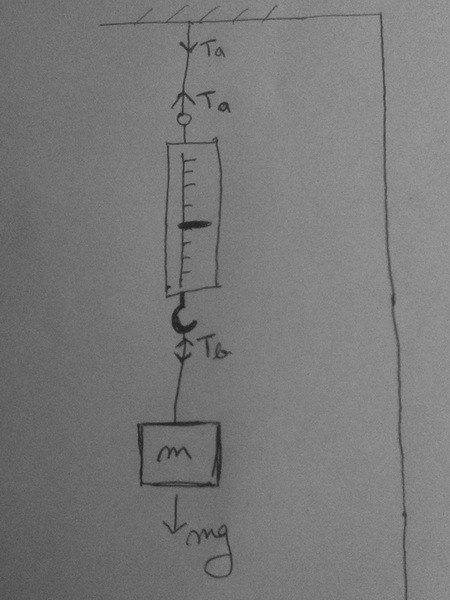

hey
what is the question asking for
Why is the spring balance 98n and not 2 x 98n
ok rockclimber
I have a question for you
suppose a a spring balance is hung on a wall with the help of a string
and mass m hanging down with the help of a string
what will spring balance show ? reading

Do you find any similarity in this figure and you rquestion ?
in terms of tension aboce the spring and below the spring?
Yes, the similarity is that the spring is just in a different position,
so the spring will read the same no matter where it is in the system.
Ta = Tb
Is therefore tension force at any point in the rope a pair ( action and reaction ) ( I looked this up ! )
To find the tension in the rope it is either the action force or reaction force of the entire system.
Is the answer to the original question what is the tension, its the reaction force 98n
The spring balance will read 98n because it part of the rope system
