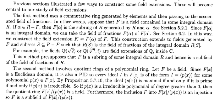

In talking about ways to construct field extensions Lovett writes the following on page 322, Chapter 7 ... ...
In the above text from Lovett, he writes:
"... ... If ##\alpha \in R - F##, then ##F[ \alpha ]## is the subring of ##R## generated by ##R## and ##\alpha##.** See Section 5.2.1. Since ##F[ \alpha ]## is an integral domain, we can take the field of fractions ##F( \alpha )## of ##F[ \alpha ]##. See Section 6.2. ... ...
(** See note at end of post ... )"My problem is that the way Lovett seems to define ##F[ \alpha ]## and ##F[ \alpha ]## seems (on the surface, at least) to be different from all the other texts I am reading ... for example Dummit and Foote or Gallian ...

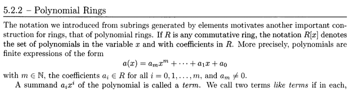

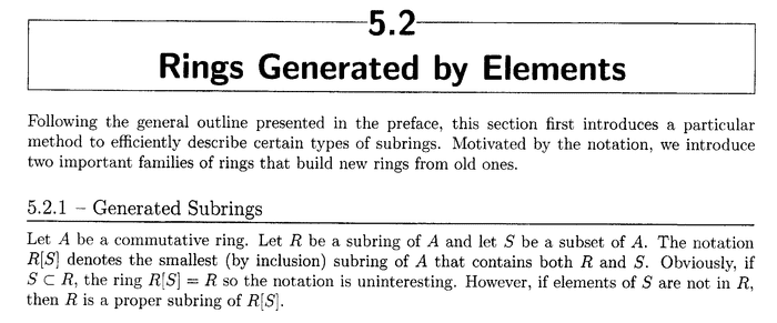

Lovett's definition of the notation ##F[ \alpha ]## comes in sections 5.2.1 and 5.2.2 where he defines rings generated by elements as follows ... ...
He goes on from the above in the next section to define rings of polynomials using the same notation as he did for generated subrings ... as follows:

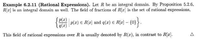

Lovett defines ##R(x)## in Section 6.2.2 as the field of fractions of ##R[x]## ... as follows:

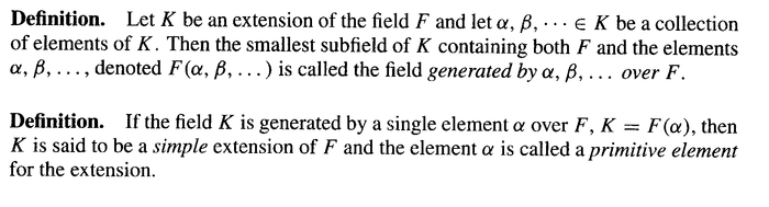

Dummit and Foote, on the other hand (like a number of other algebra texts) define ##F( \alpha )## as follows:

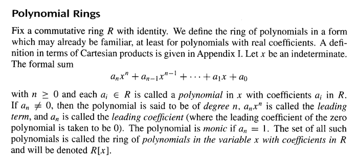

Further, Dummit and Foote simply define ##R[x]## in terms of polynomial rings ... as follows:

NOTE** Where Lovett writes
" ... ... If ##\alpha \in R - F##, then ##F[ \alpha ]## is the subring of ##R## generated by ##R## and ##\alpha##."
Is this correct?
Should this read:" ... ... If ##\alpha \in R - F##, then ##F[ \alpha ]## is the subring of ##R## generated by ##F## and ##\alpha##."
Is this correct?
No.
Should this read:" ... ... If ##\alpha \in R - F##, then ##F[ \alpha ]## is the subring of ##R## generated by ##F ##and ##\alpha##."
Yes. It's a typo.
In general variables or better indeterminants are noted by the letters ##x,y,z## or ##t## or these letters in caps. They behave like a transcendental extension as they do not satisfy any algebraic equation. However, there is no "law" that this is always the case, so in the end it depends on the author.
In contrast are algebraic numbers, i.e. those which satisfy an algebraic equation, like ##i## satisfies ##x^2+1=0## or ##\sqrt{2}## satisfies ##x^2-2=0##. Those algebraic numbers are usually denoted by small Latin or Greek letters from the beginning of the alphabet.
If ##F \subseteq R## are rings, say integral domains, and ##\alpha \in R-F##, then:
##F[x] =## polynomial ring with coefficients in ##F## and indeterminant ##x## = transcendental simple ring extension of ##F##
a) If there is no algebraic equation for ##\alpha## then ##F[\alpha] =## transcendental simple ring extension of ##F## with transcendental element ##\alpha \;;\; F[\alpha] \cong F[x]##. An example is ##\mathbb{Q}[\pi] \cong \mathbb{Q}[x]##.
b) If there is a polynomial ##f(x) \in F[x]## with ##f(\alpha)=0##, then ##\alpha ## is algebraic over ##F##. In this case
##F[\alpha] =## algebraic simple ring extension of ##F## with algebraic element ##\alpha##. If we chose ##f(x)## irreducible then ##F[\alpha]\cong F[x]/<f(x)>##.
The quotient fields (those which are what ##\mathbb{Q}## is to ##\mathbb{Z}##) are denoted by round brackets:
##F(x) =## quotient field of the polynomial ring ##F[x]##, i.e. quotients of polynomials in ##x## with coefficients in ##F##
##F(\alpha)## is the quotient field of ##F[\alpha]##.
A special notation for the quotient field of ##F## or ##R## alone doesn't exist.

But just trying to completely understand how the definitions Lovett and Dummit and Foote of ##F( \alpha )## and ##F[ \alpha ]## are reconciled ...Dummit and Foote
Adapting D&F's definition a bit ... we have that if ##K## is an extension field of ##F## and an element ##\alpha \in K## then ... according to D&F ... :
##F( \alpha )## is the smallest subfield of ##K## containing both ##F## and the element ##\alpha## ... that is ##F( \alpha )## is the field generated by ##F## and ##\alpha## ... ...
... ... while ... ...
Lovett
Lovett says that if ##R## is an integral domain (or, I guess, a field) containing a field ##F## then ...
##F[ \alpha ]## is the subring (subfield) of ##R## generated by ##F## and ##\alpha## ...
So ... my question is as follows:
How do we explain how it is that
##F( \alpha )## and ##F[ \alpha ]## seem to be defined (by two different texts) as the same thing ... ...Can you help?Peter
Math Amateur said:
Dummit and Foote
This is correct. We need the least all elements of ##F##, all powers of ##\alpha## and all quotients of them. On the other hand this defines a field ##F\subseteq F(\alpha) \subseteq K##, so it's the smallest with these properties.
Lovett
You must not assume a field. Maybe ##F## is a field in the ring ##R##, as ##\mathbb{Q} \subseteq \mathbb{Q}[\pi]## is a subfield in a ring, too. But ##F[ \alpha ]## only contains the polynomials in ##\alpha##, which means you don't have the quotients with ##\alpha ## automatically included: ##\alpha^n \in F[ \alpha ] \, , \,n \in \mathbb{N}\, , \,## but ##\frac{1}{\alpha} \notin F[\alpha ]##. At least not in general like ##\frac{1}{\pi} \notin \mathbb{Q}[\pi]##. However this example heavily depends on the fact, that ##\pi## and ##\frac{1}{\pi}## are transcendental numbers and you cannot express one by the other with polynomials; you need them both to get a field.
Things change, if ##\alpha## is algebraic over ##F##, that is it satisfies an equation ##0=a_n\alpha^n + a_{n-1}\alpha^{n-1} + \ldots + a_1\alpha+a_0## with coefficients ##a_k## in the field ##F##.
I leave it as an exercise for you to show that ##F[\alpha] = F(\alpha)## in this case.
