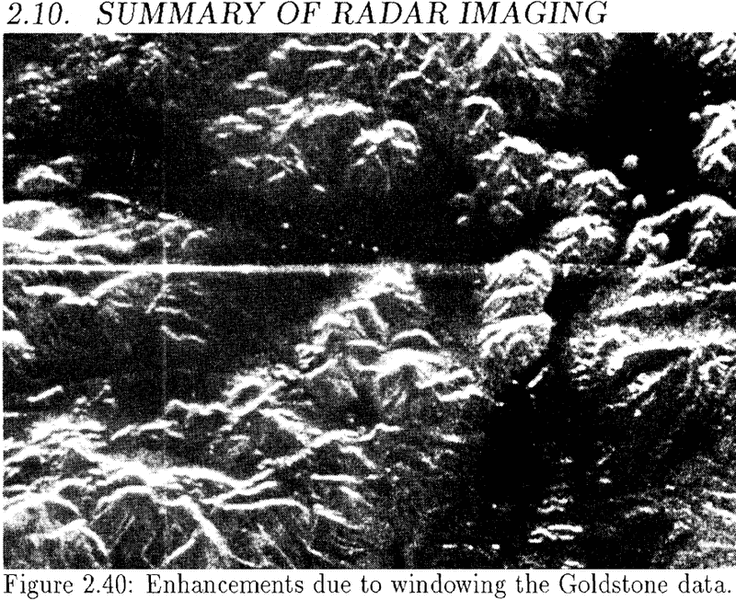

J. Patrick Fitch in “Synthetic Aperture Radar”, 1988, writes on page 75:
“The final scene is a 1024 by 1024 pixel image with each pixel representing an area on the surface of the Earth about 25m on a side. The bright star-shaped reflection in the left side of the image is a 26m antenna installed at the Goldstone Deep Space Network tracking station in southern California. The tails of the star shape, which are caused by ringing in the point response, can be reduced using windowing techniques applied in the frequency domain. The results of using a cosine–squared window are shown in Figure 2.40. The faint cross pattern of bright spots, visible to the right of the antenna, corresponds to a set of nine reflectors, ranging in size from 2 to 3m and spaced about 300m apart.”
I presume the antenna was not pointing at the radar, but still gives a strong reflection.
It is interesting that a reflector antenna should re-radiate if terminated with a matched load. But we normally assume that half the incident power is re-radiated from an antenna. I have seen the reflection from a 3m diameter microwave link antenna in the form of echoes on the pulse response at a distance of about 20 miles.
You can expect it to re-radiate if the radar is outside the bandwidth of the front-end. It just happens that the 26 metre dish was originally designed to track fast satellites, but I think what shows is the glints from the huge metal support structure rather than the dish surface. Tracking a radar satellite with a 26m dish would be over-kill for the cooled receivers at the focus.
