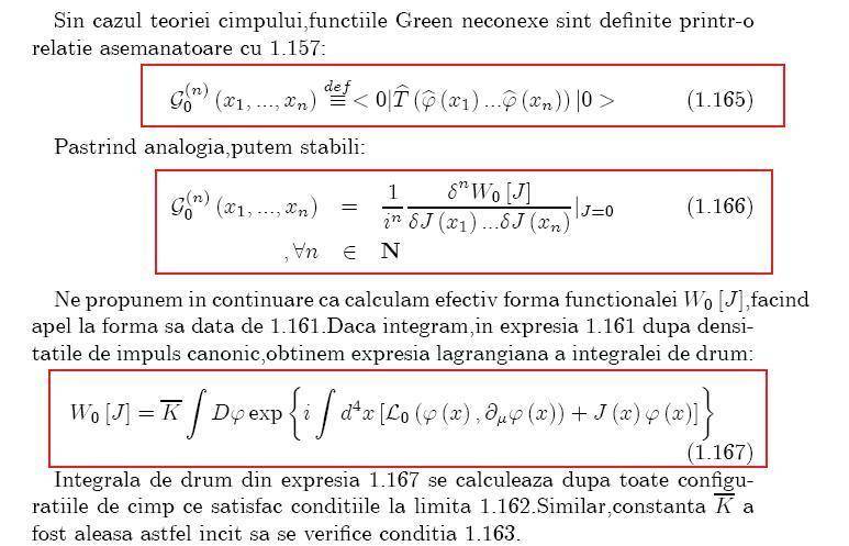

I've attached the formulae for the free scalar field in the coordinate representation. Passing to momentum representation is through a Fourier transformation of the propagator. The text is in Romanian and reads roughly
<For the field theory, the unconnected Green functions are defined through something similar to the finite degrees of freedom case
Formula 1
through analogy
Formula 2
If we integrate the Hamiltonian form of the path integral, we get the Lagrangian version
Formula 3>
You need the case n=2.
Formula 1
through analogy
Formula 2
Formula 3>
