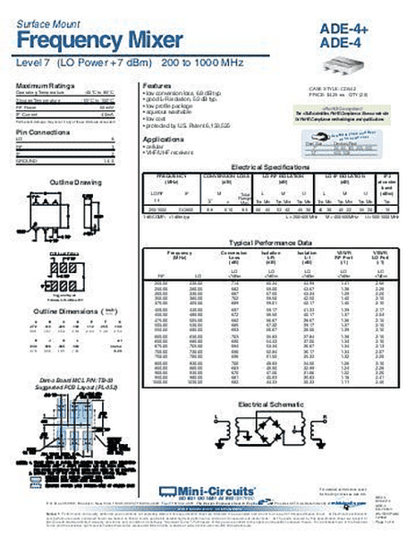

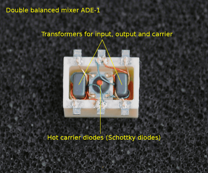

all the mixers I have ever used are passive as in there is no additional power supply added
The mixers are usually made up of a diode bridge and inductors ... eg the much used Mini-circuits brand
eg... just one example
Dave

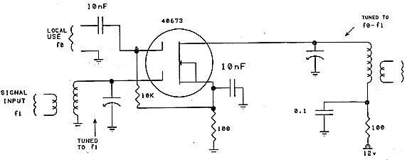

Ohhhh almost forgot
one other common form of mixer I have seen/used/worked on is using a dual gate MOSFET
RF in on one gate, LO in on the other gate and the output out of the drain
a representative circuit of that system.
ohhh gosh, this one takes me back 40 years ago when I build my first 50MHz to 28MHz down converter
the 40673 was the dual gate MOSFET of the day haha
Dave

Additionally, it's not the diodes' nonlinear behavior that produces mixing in a double-balanced diode mixer, e.g. a typical Mini-Circuits unit. In fact ideal diodes would work better than real ones.
The diode bridge acts as a chopper, chopping up the input by the reference which is ideally a square wave. So we're multiplying an input sine wave (typically) by a square wave. Fourier series analysis yields all the harmonics which are copious!

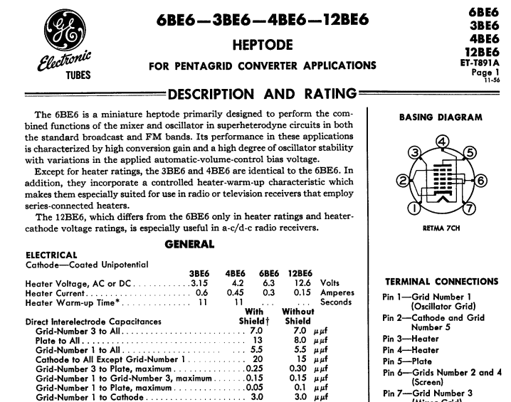

I'm still living in the days of 6BE6 pentagrid converter. .. works as Sophie described .
http://rtellason.com/tubedata/6BE6.pdf
The spec sheet is a poignant reminder of the glory days of GE before they became a bloated conglomerate including finance and entertainment. I still have two editions of the GE Transistor Manual - irreplaceable!
