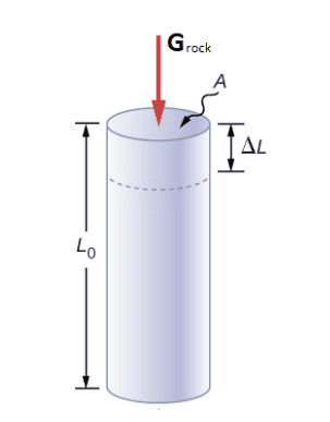

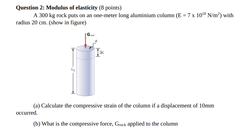

A ##300## kg rock puts on an one-meter long aluminium column (##E = 7 * 10^{10} N/m^2##) with radius ##20## cm. (show in figure)
(a) Calculate the compressive strain of the column if a displacement of ##10##mm
occurred.
(b) What is the compressive force, ##G_{rock}## applied to the column
##\sigma = E\epsilon## and ##\epsilon = \frac{\Delta L}{L}##
a) I can find the compressive strain on the aluminium column using the formula ##\sigma = E\epsilon## as we know ##\sigma = F/A##. The area of the column is ##A = \pi r^2 = 0.126m^2## and the force on the column is ##F = 300*(9.8)N = 2940N##. The stress therefore is ##\sigma = \frac{2940N}{0.126m^2} = 23333.333N/m^2##
hence plugging the stress(##\sigma##) and the Modulus of Elacticity(E) into our original equation we find the strain, ##\epsilon = \frac{\sigma}{E} = \frac{23333.33}{7*10^{10}} = 3333.332857*10^{-10}##.
But if we use the definition of strain ##\epsilon = \frac{\Delta L}{L}## we get ##\epsilon = \frac{0.01m}{1m} = 0.01##. The compressive strain obviously can't have two different values, so where have I gone wrong in my reasoning?
b) Also Just to be safe the compressive force ##G_{rock}## applied to the column would be the weight of the rock i.e., ##300g N = 2940N##?

Seems like they over constrained the problem to me.
Likes Chestermiller
are you saying there's a mistake in the question?
If you are given a modulus of elasticity and a strain, then the stress is fixed.
If they were intending for you to calculate ##G_{rock}## they bungled it when they gave its weight, and the deflection (and other relevant properties) it caused. Deflection is given by
$$ \epsilon = \frac{ \delta}{L} = \frac{P\cancel{L}}{\cancel{L}AE}$$
You have everything on both sides, and if you did it the math correctly (which I didn't check as a yet) they don't match...

Not only is it overconstrained but the numbers are in violent disagreement.
A 10mm displacement is huge. Maybe it should be 10μm? That still leaves a factor of 30 to be found somewhere.
Likes erobz
so what do you reckon I do now? This problem is on my homework and I need to put one of the answers which one should I put.
The modulus method should equal the compression displacement method which is actual for low levels , which this is.
I cannot imagine 300 kg doing 10mm compression on a 40 mm diameter aluminum column and this is faulty data.
Are you sure it gives the displacement as 10mm, not 10μm?
Are you saying it is multiple choice? If so, what are the options?
its 10mm.
It's not multiple choice.
Hamiltonian said:
its 10mm.
Then I give up. Even the grammar is faulty. What book is this?
