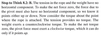

Net force has to be already zero (T = mg). But, the torque isn't zero, otherwise this question would have another answer choice. But the gravitational torque should cancel with the tension torque right?
I looked at the answer and it says "the tension does not exert a torque." But, I've done so many of those pulley problems with pulleys w/ masses using forces and torque in which there are two tensions in the rope and the torque is (T1-T2) = I*alpha.
Why does the tension not apply in this problem as torque but does in the pulley problem?

The answer says that the tension doesn't provide torque though. I understand that it doesn't provide torque if the axis was at the place where the rope touched the plank, but the key says that it doesn't provide torque even if the axis was the pivot. If it did provide torque, the net torque would be 0Nm since r = r and T = mg. Why is there no torque by the tension w/ the axis as the pivot?

I think I might've misunderstood the answer sheet, but I still don't get it:
If the axis was the place where the rope touched the plank, then tension torque would cancel with the grav torque. But the axis is the pivot.

No, it quite clearly says it is taking the point where the rope attaches to the beam as the axis.
"Consider the torque about the point where the rope is attached. The tension provides no torque [there]. ... the pivot force must exert a clockwise torque [there]."

But then... wouldn't the gravitational torque also be 0 since r = 0? Neither the tension or weight forces would apply torque.. I'm so confused...

No. Call the pivot point P and the rope attachment point R. The beam need not be uniform, so let its mass centre be at G. Say the force at the pivot is F. Moments about R are:
  • Zero for the tension
  • Mg x GR anticlockwise for the weight of the beam
  • F x PR for pivot force.

Yeah, I'm officially dumb. I completely forgot about center of gravity...
