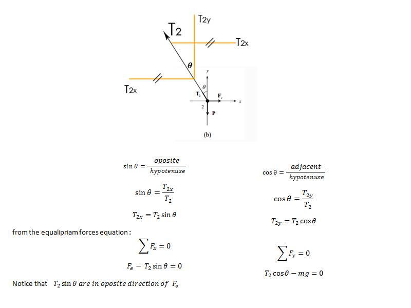

So, what I did was the following:

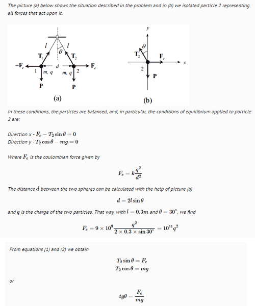

[tex]\tan \theta = \frac{\vec F}{\vec P} \\ \Rightarrow \frac{\sqrt 3}{3} = \frac{\vec F}{m\vec g} = \frac{\vec F}{0.0005 \times 9.8} = \frac{\vec F}{0.005} \\ \Rightarrow \vec F = \frac{\sqrt 3}{3} \times 0.005 = 0.0028 \\[/tex][tex]k \frac{q^2}{d^2} = 0.0028 \\ \Rightarrow 9 \times 10^9 \times \frac{q^2}{0.3^2} = 2.8 \times 10^{-3} \\ \Rightarrow q^2 = \frac{(2.8 \times 10^{-3}) \times (9 \times 10^{-2})}{9 \times 10^9} = 2.8 \times 10^{-14} \\ \Rightarrow q = 1.7 \times 10^{-7}C[/tex]My result did match the answer in the textbook, but searching through the web, I came across a different way of solving it:
The rest is just like mine, so I didn't bother putting it. Anyway, he reached the same result, but with a different method and trigonometric relations, which I'm quite lacking in and I couldn't understand very well yet.

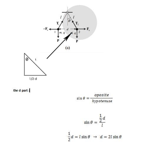

Why did he conclude that
and
I know I could just go on and ignore this because I already solved the exercise, but vectors are a puzzling topic for me and I feel like there's something I'm missing... I'd appreciate some help!
i hope that help
Likes Bunny-chan
the d part :
Likes Bunny-chan
