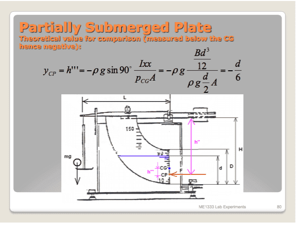

To determine the hydrostatic thrust acting on a plane surface immersed in water. Besides that, identify the position of the line of action of the thrust
i don't get it how to get h''' especially the part sin 90( Ixx/Pcg A ). I would really appreciate it if someone can give me some guidance to understand it. Thank you
That's quite a complicated diagram, and far from self-explanatory. A textual description would help.
