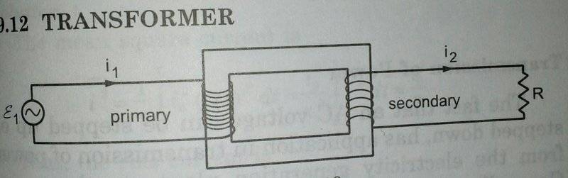

In summary, the induced EMF in the primary coil is of magnitude N1dΦ/dt, with the top end being positive and the bottom end being negative when there is a crest of the sinusoidal voltage. This follows from the polarity of the top and bottom ends being decided by the "direction (or sense) of windings", known as the "dot convention" in magnetically coupled circuits. Similarly, for the secondary coil, the induced EMF is of magnitude N2dΦ/dt, with the top end being negative and the bottom end being positive. This is due to the secondary coil being a continuation of the winding of the primary and the induced EMFs must be in the same sense. The minus
Vibhor
971
40

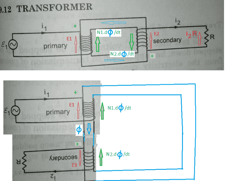

This is a snapshot of the diagram in the high school textbook.

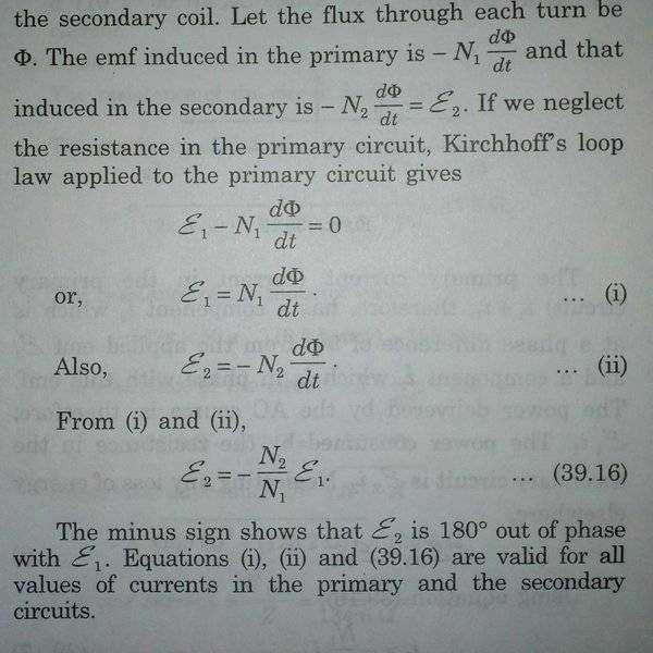

and here is the accompanying text
I would like to understand the "minus" signs in
- N1dΦ/dt and - N2dΦ/dt
This is my understanding -
When there is a crest of the sinusoidal voltage i.e top terminal of the input voltage is positive , then due to induced EMF in the primary coil of magnitude N1dΦ/dt , top end of the primary coil is positive and bottom end is negative .Now if we write the Kirchoff's law around the primary circuit then we get the desired equation as given in the text .
Is this reasoning correct ?
But in this case magnetic flux would be anticlockwise around the core , so now an EMF of magnitude N2dΦ/dt would be induced such that top end of secondary coil is negative
and bottom end is positive .
But then why is EMF in secondary coil written
as -N2dΦ/dt and not simply N2dΦ/dt ??
Please help me understand the negative signs in the induced EMF terms .

The polarities of the top and bottom ends are decided by the "direction (or sense) of windings".
Look up "dot convention" in magnetically coupled circuits.
https://en.m.wikipedia.org/wiki/Polarity_(mutual_inductance)
The induced voltages can be either in phase or 180° out of phase, depending on the sense of windings.

Seems ok to me.
But in this case magnetic flux would be anticlockwise around the core , so now an EMF of magnitude N2dΦ/dt would be induced such that top end of secondary coil is negative and bottom end is positive .
Depends on the way the secondary is wound. It took me a while to be sure which way it is, as it looks to be wound differently from the primary. But I've slid it round to the same side and you can see it more clearly (I think).

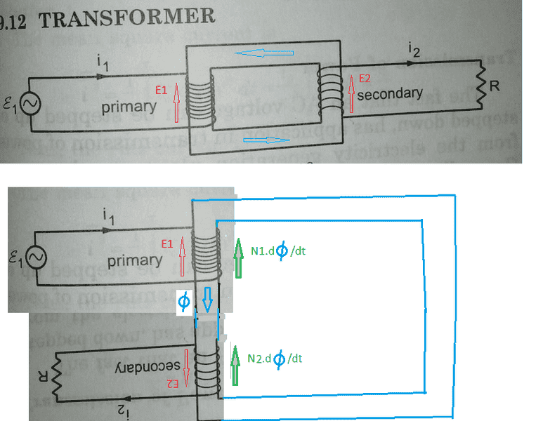

Quite honestly I haven't worked out whether the primary or secondary should have the minus sign for the induced emf. You can do it by thinking of the wires and direction of field, but you have to be careful in translating from one diagram to another (at least I do!)
What I think is obvious from this diagram as redrawn, is that the secondary is a continuation of the winding of the primary - or is like the primary slid along the core. Therefore the induced emf's must both be in the same sense as shown.
But the E's must be in the senses I've drawn: the primary because it must oppose the driving source; the secondary because it must be in phase with the current for a resistive load.
So it seems they are correct that E1 = + N1dφ/dt and E2 = - N2dφ/dt
I tend not to bother with the signs in the calculation, just the magnitudes and use my understanding to know what the phase relations are. Quite often in transformer questions, there is no information about the sense of the windings (unless, as cnh says, they mark dots to show it) so you can't put it into the equation. Where the loads are complex (reactive) you do need to take phase into account in your equations, but you generally rely on the dots to indicate the sense of the induced emfs.

Vibhor said:
But why is there a minus sign in the two EMF terms ?
In fact, if both the windings do not have a common electrical ground, the minus signs don't make any sense. We can't say whether primary and secondary voltages are in phase or out of phase, because there is no common reference.
The minus sign in Lenz's law only highlights the fact that the induced emf "opposes" the cause of its induction.
In your image, the instantaneous current directions shown are correct.
The top of the primary is positive.
Current I1 is "entering" the primary from the top, hence using the right hand rule, the flux is anticlockwise.
The secondary flux due to I2 should be clockwise, hence, again using the right hand rule, the current I2 should be "leaving" the secondary from the top.
To make it so, the top of the secondary should be positive.
Hence, when top of the primary is positive, top of the secondary is also positive.
If you connected the bottoms of the two windings together, there will be a common ground to both the circuits.
So now with a common reference node, you can say that the voltages E1 and E2 are not 180 degrees apart, but are in phase.

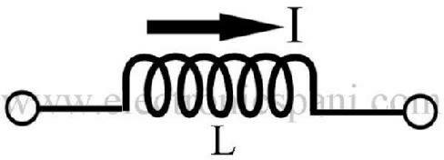

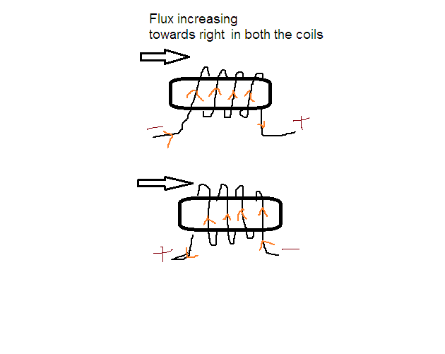

I really appreciate both of yours response . But while trying to understand transformer , I am bit confused about the direction of self induced EMF in an inductor .
In the above coil the current increases towards right . But the winding is such that when looked from the left terminal , the current moves counter clockwise .The flux increases towards left . In case the winding is such that when looked from left , current moves clockwise .The flux increases towards right .
But in both the cases , the direction of induced EMF would be such that it opposes the cause of change in flux This cause is the increase in current .So induced EMF would tend to oppose the increase in current .So left terminal would be positive and Right terminal negative .
So , is it correct to say that the polarity of induced EMF is independent of the windings of the coil ??
You are right when you say "polarity of the induced emf is such that it 'opposes the cause' of its induction."
Suppose you have two coils with opposite winding senses and they are not magnetically coupled.
If you increase the flux in both the coils, it will induce emfs in both the coils. But the polarities of the emf will be opposite. Because the induced emf will try to drive a current that opposes the increase in flux. If the winding senses are opposite, the induced current directions are also opposite, and hence, the polarities of the induced emf are opposite.
This means, the polarity of the induced emf depends on the sense of the winding. It is the 'flux from the induced current' that is independent of the winding direction.

Well, I was talking about a different scenario where you increase the flux using some external mechanism. I'll explain it later (I can't draw figures right now).
Merlin3189 said:
But it doesn't matter. If it were wound in the opposite way, the flux would have the opposite sense, but the turns would go in the opposite direction, so the emf would stay exactly the same.
This is correct. Because in your inductor example, if the current is increasing towards right, its left terminal is obviously hooked up to the +ve terminal of a voltage source. So the induced emf has to be independent of the winding direction, otherwise it would violate KVL, wouldn't it?

How is flux clockwise ? And we are looking from top or bottom ?
Sorry , I am still not clear why the top of secondary coil should be positive .Please see my post 10 .
Vibhor said:
think , since the flux is increasing upwards in the secondary coil , the induced EMF should be such that the bottom terminal is positive and top is negative .
The secondary current should be such that it produces a flux in clockwise sense i.e. downwards in the secondary limb.
Applying right hand rule, the current direction comes out to be the one that is shown in the diagram i.e. I2 leaves the secondary from its top.
This means the top should be +ve.
Use the right hand rule for primary and you'll see the primary flux is counterclockwise. So to oppose this flux, the secondary flux should be clockwise.
We are looking at the diagram from outside the plane of the paper, neither from the top or the bottom.
The coils are not connected to any source. The magnetic flux in the core is increasing towards right via some external arrangement.
Orange arrows show the induced current. You can see that the polarity of induced emf changes with the direction of winding.

Vibhor said:
@Merlin3189 , in your post#4 , in the top figure , could you please explain the direction of E2 ? Why is it upwards ?
I think , since the flux is increasing upwards in the secondary coil , the induced EMF should be such that the bottom terminal is positive and top is negative .
you're right.
I put E2 in the same direction as their current flow through the resistor. I put E1 to oppose the current flow from the source. These are arbitrary decisions. If the emf or current turns out to be in the opposite sense to your arrow, it just comes out as negative.
Then in the bottom diagram I showed the induced emf in coil 2 in the same direction as the induced emf in coil 1, because they are wound the same way when looked at from the (arbitrary) flux direction through both coils.. (This bottom diagram was just an easy way to see the relationships between the induced emfs.)
If you look at my updated picture below, you can see that indeed the "polarity" of the secondary (based on an assumed polarity in the primary) is as you say.
So, as they say in the text, E1=N1.dφ/dt and E2=-N2.dφ/dt
This leads to i2=E2/R=-(N2.dφ/dt )/R
meaning that i2 is negative, ie.in the opposite sense to the arrow and so producing an opposite flux to that produced by the primary (since both coils are wound in the same direction - cw viewed from the top in my lower diagram.)

@Vibhor, I think I've made a mistake in applying the right hand rule to the secondary.
Using right hand rule, to set up a clockwise flux, the current should leave the secondary from the bottom, meaning the bottom should be +ve and the top should be -ve.
And yes, then E1 and E2 are 180 degrees apart.
I took the secondary winding sense wrong (maybe due to my phone's small screen).
So if the bottom is positive, the current I2 should be leaving the secondary from the bottom.
Sorry if I caused any confusion!

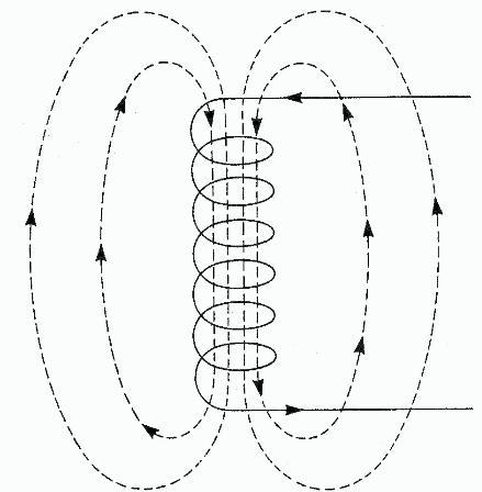

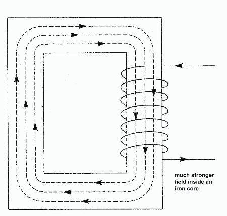

The magnetic field inside the coil when there is no iron core inside it is given by
But when the coil is wrapped over a core it becomes
Note : Somehow primary coil is absent on the left side in the above image .Please assume it is present .
So , how is it that when iron core is present , the entire magnetic field and flux is contained within the core and field lines roughly take the shape of the core ??
In other words how is iron core able to guide all the field lines from the coil to move along the core , looping back to the coil ??
Please explain how magnetic field lines change their shape from top figure to the one in bottom figure .
The reluctance of the iron core is negligible compared to that of the air. Hence, almost all the flux flows through the core.
Compare this magnetic circuit to an electric circuit. Electrical resistance is equivalent to magnetic reluctance, emf is equivalent to mmf (amp-turns) and electric current is equivalent to magnetic flux.
In electrical circuits, if you put a very low resistance across a very high resistance, most of the current passes through the low resistance. Similarly, almost all the flux flows through the core. Real world transformers have some leakage flux that completes its path through air (or surrounding medium). This gives rise to a leakage reactance, which is an important parameter while designing power and distribution transformers.
Likes Merlin3189 and Vibhor
