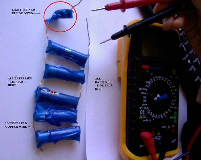

Batteries are connected in parallel. Multimeter shows: 1,5V AND... "0.12A" regardless of battery number. Volts stay the same but should not Amps add up in parallel? "0.12A" with 4, 5 or 6 batteries...
Details: Amps measured correctly by closing the circuit with multimeter probes (bulb lights up)
Posted this under "physics education" because my question is trivial. I am very new to electronics.

It seems that you are powering a light globe from some 1.5V cells, and you are finding that the current to the bulb stays unchanged regardless of how many cells you connect in parallel?
Were you expecting that with more cells connected there would be more amps through your light globe?
Contrast what you are doing here with what happens in a different experiment where you connect the extra cells in series.

Yes. One 1,5V battery cannot light the bulb up. When I connect batteries in parallel voltage remains the same "1,5V" (regardless of how many batteries I connect), so something else must change since the light NOW shines with 4, 5 or 6 batteries connected in parallel.
When you connect batteries in series voltage rises, amps stay the same - so I thought when you connect batteries in parallel voltage stays the same, but amps rise. Otherwise why is the bulb shining with 5 batteries and not with 1, when voltage is 1,5V in both cases?

Something else is going on, something that you haven't considered. When you measure the voltage and report it as being 1.5V, you should be measuring the voltage across the light globe when it's powered. So connect your meter across the light globe and tell us that voltage with 1 cell, then with 2 cells, and so on.
Amps stay the same? Can you use Ohm's Law to show that you are right?

Batteries in parallel increase the available amps. You have a light bulb in circuit which at a given voltage requires a specific number of amps. Once you have enough batteries in parallel to able to source the number of amps required, you can add as many batteries as you wish and it will make no difference other than it will take longer to run the batteries down.

If you connect batteries in parallel, the voltage remains the same, thus the current remains the same across the same load. If you connect a 12 Vdc battery across a 24 ohm resistor, you will induce a current flow of 0.5 amps. It doesn't matter whether the battery has a storage capacity of 3 amp/hours or 300 amp/hours. If you want to increase the current through the load you need to increase the voltage of your power supply or decrease the resistance of the load.

The amount of current which flows is determined by the resistance of the bulb and the supply voltage.
These will be more or less the same regardless of how many parallel batteries you have.
(The bulb resistance might vary a small amount when hot at opposed to cold, but not enough to make much difference)
