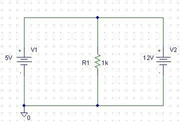

What will happen if two batteries were connected in parallel, and how could the total voltage and current be distributed among the resistors?
Like in this attachment considering that the internal resistance of the 12V battery is 3 ohms while the resistance of the 5V battery is 2 ohms
The 5V battery will likely catch fire.
Voltage sources are not connected in parallel, unless their output voltages are closely matched.

Why would it catch fire ??
Because you are driving an overcurrent backward through the 5V battery (and drawing a large current out of the 12V battery). That's generally a bad thing to do with batteries, depending on what chemistry they are.
An ideal voltage source has a very low output resistance, so when you try to connect voltage sources of different output voltages in parallel, you will be drawing large currents and forcing large reverse currents. Not a good idea.

I want to overlook all the problems that might arise due to this connection, I will prevent the reverse current by readjusting the position of one of the sources and I will control the situation by perfect, ideal circumstances to prevent any damage, even If that's impossible, I'm just curios how would the voltage and current be distributed among the resistors (theoretically speaking).
and how do you propose to do that ?

I'm not the one who did this circuit I just found it on one of the websites and I copied it here I don't know how can I show you, I'm just saying in this circuit I'll reverse the position of one of the sources
If you do that with batteries, you will most likely damage one or both of them.
If you do it with power supplies, the higher voltage power supply will supply all of the load resistor current, and the lower voltage power supply will not supply any current to the load (its output would be shut off by the higher voltage at its output.

Thanks a lot that's a clear answer, I just want to ask one more thing, what if the voltage of both sources were nearly equal as you mentioned earlier
If they are batteries, they will fight each other a little bit, but level off at some intermediate output voltage.
For power supplies, the higher voltage will still dominate and shut off the lower voltage power supply. Most power supplies can only source current, they cannot sink current. So the lower voltage power supply will basically have its output stage shut off by the higher voltage power supply.
There are some very sophisticated systems that have multiple power supplies that share sourcing current for loads, or act as redundant backup supplies to be sure that the failure of one power supply will not take down the system.

How is the intermediate voltage calculated?

You really misunderstand what I meant by " I can't show it ", I meant that I don't have any kind of software to redraw the circuit that visualizes what I mean. So I'm saying it in words instead of a diagram.
It would depend on the relative sizes of the batteries and their state of charge. Given the same size/capacity batteries with equal charges but off by 0.2V in their output voltages, the sum would close to the average output voltage.

Consider the following circuit:
http://www.ibiblio.org/kuphaldt/electricCircuits/DC/00207.png
The voltage at the node between the resistors is:
V = (V1/R1+V2/R3)/(1/R1+1/R3+1/R2)
Suppose R1 = R3 = R. Then:
V = (1/R)(V1+V2)/(2/R+1/R2)
V = (V1+V2)/(2+R/R2)
Now let R go to zero, and you end up with that illegal circuit you had in the first image. Of course, we've made some illegal assumptions, so it's probably not what happens in reality, but it sort of captures the idea. Assuming your batteries don't blow up, the average voltage will be close to the output voltage.
The idea of a battery is that it pumps out as much current as possible to sustain a given voltage. However, in your illegal circuit, neither battery pumps out the correct amount of current to produce the correct voltage. Both batteries are still going to pump out what current they believe are correct, but the excess charge is going to travel from the stronger battery (12 V) to the weaker one (5 V) and mess with whatever chemical reaction is going on inside (which is described by the Nernst equation).
