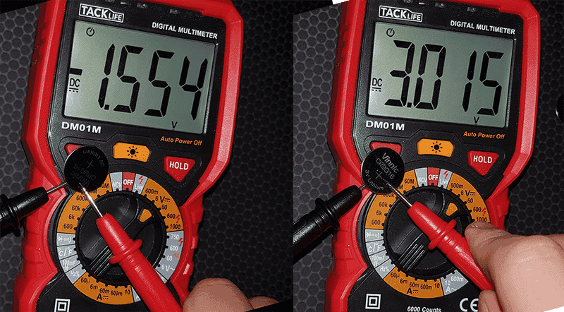

So, some time after getting a new car the batteries on my FOB died. So I went in and replaced them, two CR2016's was all that was needed (on top of each other in parallel). No more than a month later I noticed the battery felt like it was dying already (light not as strong, delay on the actions etc.). It died pretty soon after so I went ahead and changed them again, before I did this however I took a multi meter to the batteries, the batteries are rated at 3v, one was at some positive voltage and the other was at some negative voltage (it's been a while so I can't remember exactly). Again the batteries died pretty quickly, so today before changing them again I checked it, one battery is at +3v, the other is at -1.4v. This is completely perplexing me, does anyone have any insight as to why this might be happening?

The multimeter should be absolutely fine, it's under a year old and has only been used on small electronics with low voltage/amps. I'm testing both the batteries in the exact same configuration (I'll attach some images of the test for sanity's sake). I also came across that article you linked sparkie but I can't see how it could really apply here. The readings especially don't seem to make sense, I could see the one battery dying and then somehow being reverse charged by the other due to some issues with the board but having it reverse charge all the way to -1.4v while the other is at 3v (the good battery would have had to been freshly charged to well over 4.4v in order for this to happen) seems bizarre.

Minor change is that the negative battery is at -1.5v not -1.4v (I think I was losing 0.1v from holding it in my hand while testing earlier).

That is nuts. I have not seen that before. The thing is, in order for that battery to develop a potential in the opposite polarity, it has to have a source of charge. As that article suggests, the battery would need a reverse polarity. It also pays to remember that the potential on a battery is created due to a difference in energy. You could have a 3v nominal battery give off a certain amount of its stored energy, creating a -1.5v charge on the other battery, yet still maintain a 3.0v charge while not under load. Something is obviously wrong with your FOB, as there is an unintended path, likely through some resistance in the device, that is causing the battery to discharge in this manner when the device should be open and no current flowing.
The next step would be the take an amp reading with the batteries connected and none of the buttons pressed to verify that there is a parasitic drain on the circuit (presuming you don't just want to go buy a new FOB instead).
