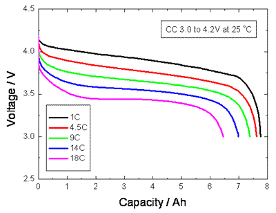

The calculation/answer looks correct to me. But as said, results of an actual test may vary due to the high discharge rate.
It would depend on the battery chemistry, Lead-Acid vs Li-Ion for instance.
Lead-Acid batteries are generally rated in AH based on a 10 hour discharge rate. If you discharge at 10 times that rate, 1 hour in your case, they can supply around 5% of their rated capacity.
You could probably get 65%-75% from a Li-Ion battery under the same discharge conditions.
Here are some curves for the two chemistries:
Lead-Acid, about 1/3 of the way down the page.
url=https://electronics.stackexchange.c...aw1IGYYBVunaPhzD6P0kvhG2&ust=1574661829762700
Li-Ion curve from:
https://www.mpoweruk.com/images/discharge-C-rate.gifFrom https://www.mpoweruk.com/performance.htm
Cheers,
Tom
shahabkhan said:
It will be used in hybrid vehicle along with 100 kW fuel cell.
If that is your project, then you need to go much deeper into the real battery characteristics than those extremely simple formulas.
You need the discharge curves that @Tom.G linked.
You need the condition and age of the batteries.
You need temperatures, and sensitivity of batteries.
You need to consider battery lifetime.
You need to consider power versus time. It will not continue to deliver the same power all the way down to zero charge.
Efficiency is a function of discharge rate.
It goes on and on. My point is that you need to go much deeper.
Likes BvU, zoki85 and jrmichler

Did you look at the links that @Tom.G provided? One of them is a curve.
Did you read the articles at batteryuniversity.com?
Things like that are normally treated empirically, not theoretically.
