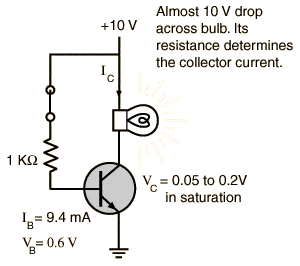

http://hyperphysics.phy-astr.gsu.edu/hbase/solids/trans2 depends on the amount of current entering it's base. With no current, it's said to be in "cut-off" (i.e. there's no collector current or relay current in your case).
With a large enough base current, it's said to be in "saturation" (i.e. there's a high collector current; causing the relay to operate or close the switch in your case).
See: Transistor Switches

Probably easiest explained this way:
Current flowing through a relay coil creates a magnetic field which collapses suddenly when the current is switched off. The sudden collapse of the magnetic field induces a brief high voltage across the relay coil which is very likely to damage transistors and ICs. The protection diode allows the induced voltage to drive a brief current through the coil (and diode) so the magnetic field dies away quickly rather than instantly. This prevents the induced voltage becoming high enough to cause damage to transistors and ICs.
From: http://www.kpsec.freeuk.com/components/relay.htm
The transistor and relay in your circuit are acting like the switch and inductor respectively in these images.
When your transistor is in saturation,
When you transistor is in cut-off,
From: INDUCTORS
Note that when the switch is opened, current is induced (hence the name inductor which is what the relay's coil is) lighting the lamp. By having a diode in the place of the lamp, this induced current is shunted. Hence protecting the rest of the circuit from damage.
