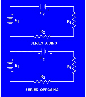

The load is the internal resistance of the battery. Which cannot be measured directly but can be calculated ....Battery internal resistance acts
like a variable resistor.R1 & R2 represents the internal resistance of a 2 battery hookup
E1 sub as a alternator then delete R2 . The diagram is the best I can do until I get more familiar with posting

If the internal resistance is modelled as an external lump, then only the charging circuit and battery are in a series opposed circuit.

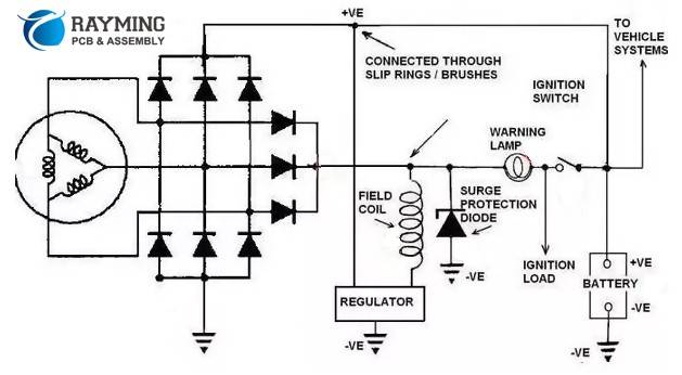

Perhaps the following image will help? Assuming the vehicle systems are connected to the chassis for ground, then the battery is in parallel with a great many things, including the alternator.

If you want to treat the leg with the battery as being in series with a power source you certainly can, as long as you don't care about what's happening elsewhere in the circuit, such as when you're just looking at when the battery is charging. You don't have to model the rest of the circuit if it isn't important for whatever you're doing.
I'd simply recognize that the alternator applies a voltage to the battery terminals. If this voltage exceeds the battery voltage then current flows into the positive terminal and the battery charges. Whether you draw this out on a piece of paper as a simplified series circuit or a parallel circuit is up to you.
So I suppose the answer is no, the current doesn't flow like a series opposing circuit. But you can sometimes treat it as if it does.

According to Kirchhoff's laws a circuit with multiply voltages....
Series-Aiding and -Opposing Sources
When multiple voltage sources exist in a circuit they can be series-aiding or series opposing.
Sources that cause current to flow in the same direction are series aiding.
Sources that cause current to flow in opposite directions are series opposing. In an opposing circuit the current flow direction is determined by the larger
