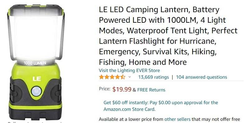

There's a simpler solution. Install a bracket near the door, and put one of these on it: https://www.amazon.com/camping-lights-and-lanterns/b?ie=UTF8&node=3401301. Your choice of disposable or rechargeable batteries, low cost, plenty of light, no wiring, no holes in the building,...
Likes berkeman and russ_watters
