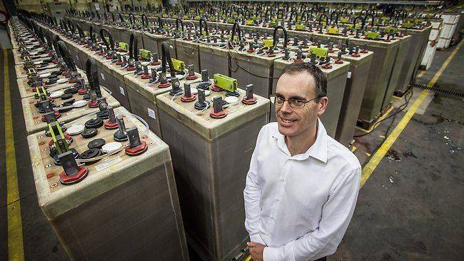

I would share how many volts the battery on my submarine was rated at, but then, I'd have to kill you all.
ps. I like phinds answer the best:
phinds said:
...I think the 12v standard is for safety.
We had to make sure all of our clothing was was covered in non-conductive material before working on the beast.
It was easy to remove metallic objects, but the zipper on our jeans was a problem. I can't remember now how we dealt with that. But, the thought of a conductor, at such a sensitive position, being shorted across >100 volts, with such a low internal resistance... hmmmm...
In an effort to cut down on waste, I usually just stripped down to my underwear.
There weren't no girls to giggle at us back then. :redface:
