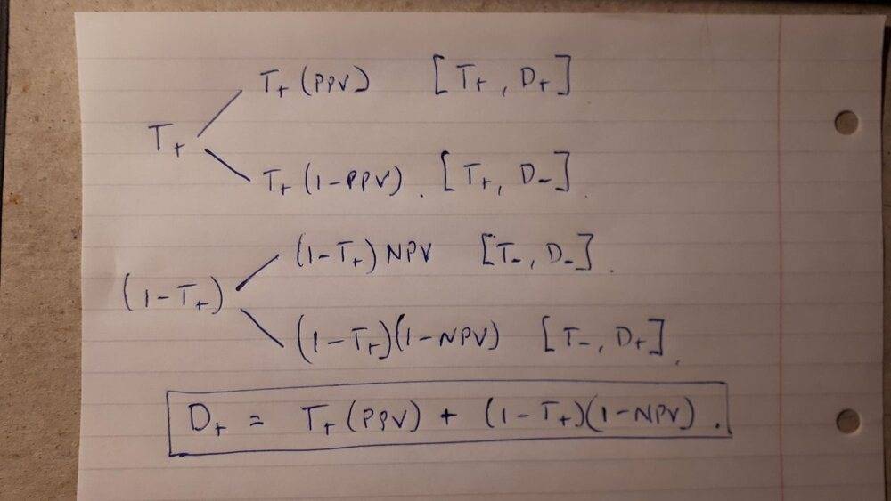

Okay, so you're going round in circles perhaps.
I find it's always easier to work from a probability tree, which gives a better insight than Bayes' Theorem (although it's the same information).
Using the tree method, the prevalance (##D_+##) falls out without any effort. The other quantities of sensitivity and specificity you can practically just read off as well.

I'm going to suggest you learn the probability tree method. These numbers are all related to each other and the best way to see this is a simple probability tree. The answers drop out (like ripe fruit, as it were!).
Did you understand the diagram I posted above?
