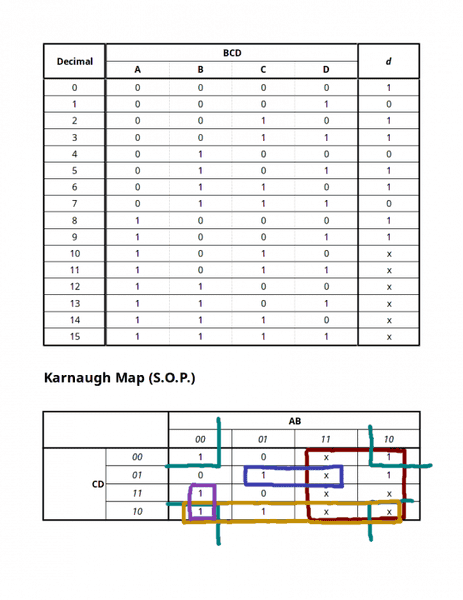

A 7-segment display is used to show a decimal digit and it is driven from 4-bit input. Each bar is assumed to light up when a logical 1 is applied to it.
  1. Draw the truth table to drive segment (d) of the display.
  2. Using the truth table you have obtained, draw a Karnaugh map to find the minimised logic expression in the 1-st canonical form (SOP, i.e. series of AND terms ORed together).
  3. Convert the expression from 2 to a function which uses only NAND gates and draw the equivalent circuit diagram in Logic Circuit and generate its truth table to compare with 1.
De-Morgan's laws:$$(A + B)' = A' \cdot B'$$$$A' + B' = (A \cdot B)'$$
[/B]
See attached for truth table and k-map.
Canonical Form:$$A + C'D + CD' + A'B'$$
Applying De-Morgan's Theorem:$$A'BCC'DD'$$
but since ##C \cdot C' = 0## and ##D \cdot D' = 0## then this all reduces to 0.
I'm not sure whether it is my K-Map minimisation or application of De-Morgan's laws that is wrong?

Yes that is correct thanks berkeman.

I'm confused though. You should end up with 7 truth tables, one for each segment drive, right?
Yes in total, although this homework is only to derive the logic circuit for segment d.
Ah, okay. I missed that if you said it in your OP. Let me check your work now...

fonz said:
I did think this originally but then I checked the example solution that was provided in the homework material and found this.

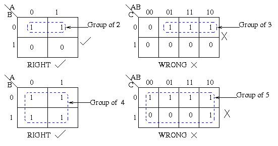

Ah, fair enough. The issue I see is the blue rectangle and green rectangle that you have around 3 terms each in your K-map. I don't think you can do that... :smile:
http://www.ee.surrey.ac.uk/Projects/Labview/minimisation/graphics/g3.gif

Great thanks for pointing that out, still got the same issue though:
Canonical:
##A + BC'D + B'C + B'D' + CD'##
Applying De-Morgan's law:
##A'BBB'CC'C'DDD'##
Now the ##BB'##, ##CC'## and ##DD'## terms all equal zero.

fonz said:
A+BC′D+B′C+B′D′+CD′
That's not what I'm getting for a corrected version of your K-map. Can you post the corrected K-map and show your groupings?
I think I am missing the ##A'## from the third minterm.
##A + BC'D + A'B'C +B'D' + CD'##

fonz said:
I think I am missing the A' from the third minterm.
A+BC′D+A′B′C+B′D′+CD′
Your 3rd minterm does include A', and I get the same minterms as you now. :smile:
