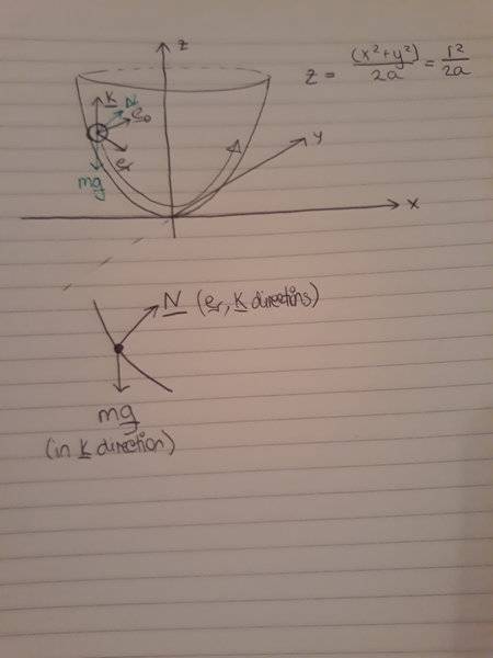

Can you post a simple free body diagram of the bead (in the simple ##v_0, \rho_0\ ## case) ?
Yes of course! Hope this will be sufficient:
Very good. This way the relationship between the forces ( ##\vec N + m\vec g = \vec F_c## ) becomes clear. An angle and a magnitude in equation form is the next step.
