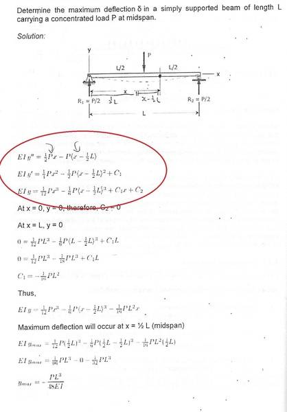

In summary: It's not clear what you are asking. Why the author ignore the moment 0.5P( L-x)?In singularity function, <x-a> = 0 only if x<a , and <x-a> =1 if x > a , but, in this question, x is drawn beyond 0.5: (a) , am i right?So, there's also a possibility of <x-a> =1 , am i right?

can someone explain about the RHS of EIy' and EIy'' ?
how to get the RHS of EIy" from RHS of EIy' ??
It's not integration of dx , am i right?
if it's integration of dx, it should look like this , right?[/B]
EIy' = 0.25P(x^2) - 0.5P(x^2) +0.5PLx ??

Why don't you think it's integration to go from EIy" to EIy'? What else would it be?
EIy' = 0.25P(x^2) - 0.5P(x^2) +0.5PLx ??[/QUOTE]
Not necessarily.

Not necessarily.[/QUOTE]for the EIy" , why shouldn't it = 0.5Px - P(x-0.5L) - 0.5P( L-x) ??

It's hard to make out from the image provided, but it appears you start with:
##EIy" = \frac{1}{2} Px - P<x-L>##
Now, the expression P<x-L> usually represents some kind of singularity function, and you don't split up the expression inside the <>.
These expressions usually have some special integration rules which must be followed.

does the author left out something ? as we can see from the diagram , there are 2 P/2 force at 2 different ends...

##EIy" = \frac{1}{2} Px - P<x-L>## this is the author's idea , my idea is = 0.5Px - P(x-0.5L) - 0.5P( L-x)
Which is correct ? the author ? or me ?[/QUOTE]
Obviously, the author is the expert on the interpretation of his own text.
You are not allowed to make up your own mathematics if it does not follow what the author intends.
why the author ignore the moment 0.5P( L-x) ?
for this question, why did C2=0?
in singularity function, <x-a> = 0 only if x<a , and <x-a> =1 if x > a ,
