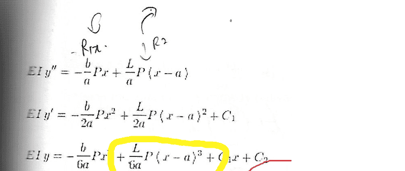

determine deflection of beam
at x=0, y=0 , i found that C2 = LP(a^2)/6 (circled part) but the author gt 0, which is correct?
The author is correct.
##EIy = -\frac{b}{6a}Px^3 + \frac{L}{6a}P<x-a>^3+C_1x+C_2##
When x = 0, y = 0, and the expression <x-a> = 0, due to the definition of the singularity function <x-a>, and C2 = 0 as described in the text.

why <x-a> = 0 ?
chetzread said:
why <x-a> = 0 ?
The way a singularity function is defined:
<x-a> = 0, if x - a < 0
<x-a> = 1, if x - a > 0
Some other properties are found in this article:
https://en.wikipedia.org/wiki/Singularity_function
You should check your text for the precise definition.

since x - a > 0, so <x-a> = 1 , am i right ? why the author take <x-a> = 0 ?
When x = 0, <0 - a> = -a; -a < 0; <0-a> = 0, according to the definition of the singularity function

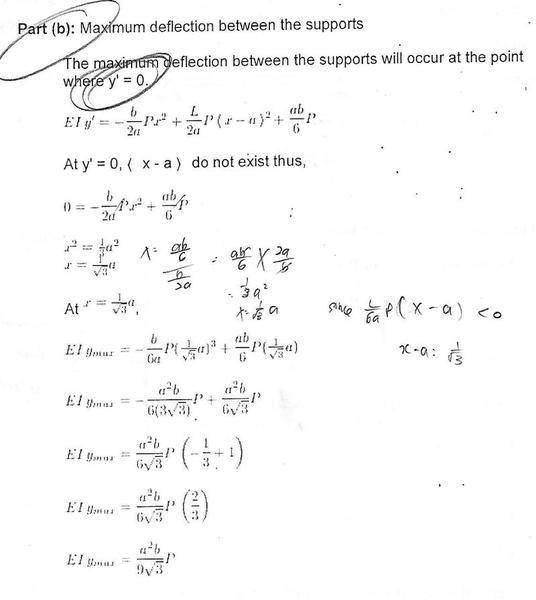

ok , i have another part of question here . in the working , the maximum deflection occur at x= (1/sqrt rt 3) ,
why the author ignore the LP[(x-a)^3]/ (6a) at x = (1/sqrt rt 3) ?
by ignoring the at LP[(x-a)^3]/ (6a) at x= (1/sqrt rt 3) , the author assume x-a <0 ?
but , the value of a is unknown , how to know that x-a<0 ?

I think the author is clumsily trying to say that the singularity function <x-a> = 0 where the deflection is at a maximum. Instead of saying "do not exist", it would probably be better to say that "<x-a> vanishes" at that location.
Anyhow, once that fact is recognized, then the location x of the maximum deflection can be solved for as illustrated.

how could that be ? the value of a is unknown
No, it isn't. a is the distance between R1 and R2. Look at the beam diagram.

if it' so , x > a , so x-a > 0 , so <x-a> should be =1 , right ?
It's not a which is unknown, it is the value of x at which the deflection is a maximum.

why <x-a> = 0 when deflection is at a maximum ??
Specifically, the problem is looking for the location of the maximum deflection between the supports.
The quantity <x-a> is going to be zero because x is located between between the supports and x = a is the location of the right support. That's just the definition of the singularity function in this case. It helps to check the beam diagram for this problem.

x is located between supports ? but , in the diagram , x span from R1 and beyond R2 ?
What do you mean ?
What do you mean ?
x is the length coordinate of the beam with origin at the left support, i.e. x = 0 there.
Sure, x can be used to locate stuff along the entire length of the beam (even beyond the location of the right support), but this particular question asks the student to find the location of maximum deflection between the supports, i.e. find max. δ(x) such that 0 ≤ x ≤ a. Again, refer to the diagram.
