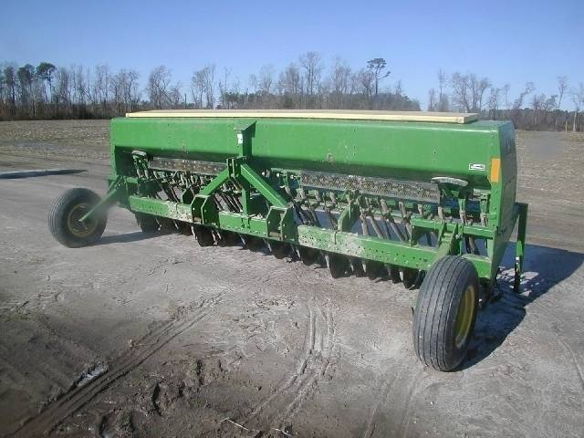

Are you asking about something like this?
http://static.auctionservices.com/images/689053/John_Deere_515_Grain_Drill_large.jpg
I think we need to know more about the "disc openers with a 450 lb trip". How do the openers operate and how would their tripping force affect the beam?
In reality, we really need to see a conceptual drawing or sketch of the whole unit you are planning to build.

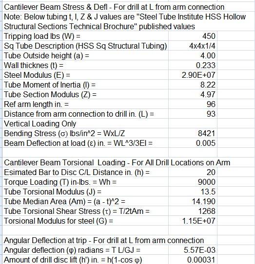

Jmsteel,
I n order to give you a bit of assistance with formulas, below is a screen print from an excel sheet for the beam stresses and deflections on one arm for the tripping load on a single drill for two conditions. The first is for a full vertical tripping load and the second is for the torsional stress of a full tripping load with a full frontal strike on the drill disc. The actual total arm stress for the second case would be some combination of the first bending stress combined with the torsional shearing stress. The first calculation represents the maximum condition for any single disc strike on any of the discs on the arm based upon the drill's distance from the hitch structure; but, the second calculation torsional stress,but not the angular deflection, will be the same for all discs on the arm.
Maybe these examples will give you a start and the equations required for calculating the stresses and deflections for these two conditions; even so, all of the factors and appropriate combinations of loads as discussed above by 256bits still must be determined for a complete design analysis.
