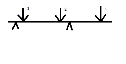

hello!
I don't understand, what is the equation that we use in beams
is it that forces 1,2,3 equal with the reactions at the two supporting points?
or the torques are 1,2,3 equal with the reactions at the two supporting points?
and how do we find the reactions at the supporting points?
thanks!
At equilibrium, the beam will not be moving. So total vertical force is zero. And total torque is zero around any point.
Recall your equation for torque. Pick a convenient point and work out the torque as a function of the force provided by 1, 2, 3, and each fulcrum.

The magnitude of the forces marked 1, 2, and 3 and their locations along the beam must be known already. This beam has only two supports, hence two unknown reactions occur at these locations.
This particular beam is statically determinant, since you can write two equations of equilibrium, which when solved, will provide the unknown reactions.
second, saying total moments is easier, but the problem is which axis should I take as reference? and if I take the axis that passes from the left supporting point, how am I going to calculate the reaction on that point, where moment is zero, since distance from the axis is zero? do you understand what I mean?
The sum of the moments about a particular point must equal zero.
If you take the left support as the reference point for calculating moments, this sum will include the moment due to the unknown reaction at the opposite end of the beam, and also the moments created by each of the forces 1, 2, and 3 about the reference point.
By selecting one of the supports as the reference point for the moment, we can write a moment equation with one unknown quantity: the reaction opposite from the reference point. By solving for this reaction, the only unknown remaining is the reaction at the moment reference, which can be easily solved by using the sum of the forces equation.

No, you are confused. There are two equations of static equilibrium:
∑F = 0 and
∑M = 0
You don't combine these two equations into one big equation, just because they are equal to one another.

There are two equations of equilibrium because we are trying to say:
1.) There is no net force on the beam, which would tend to accelerate it off into space, and
2.) there is no net torque which would tend to cause the beam to rotate about an arbitrary axis.

Analyzing your diagram in the first post, and assuming the unknown reactions are RA for the left support and RB for the right support, the first equilibrium equation is:
∑F = F1 + F2 + F3 + RA + RB = 0
where F1, etc. are the known forces applied as shown.
The second equation of equilibrium is:
∑M = (x1 * F1) + (x2 * F2) + (x3 * F3) + (xB * RB) = 0
Here, we have taken the location of RA as the reference point for measuring the moment arms xA, etc., used in calculating the moments due to each force or reaction. In the equation above, the only unknown quantity should be the reaction, RB.

In a beam with two supports, we typically write a moment equation using only one of the supports as a reference. The moment produced by the reaction at that support will be zero, but there is a moment produced by the unknown reaction at the other support. When the moment equation is written out, there should be only one unknown quantity, the reaction at the second support. Since the sum of the moments must be zero, we can solve for the reaction which makes this equation true. That gives the value of one of the reactions.
Since there are only two unknown reactions to start with, and we have found one of those unknown reactions using the sum of the moments, likewise, we can use the sum of the force equation to find the value of the remaining reaction, the one which occurs at the reference location we originally selected in order to calculate the moments acting on the beam.

If F3 were a force, instead of being included in the sum of the forces equation, it would be included in the sum of the moments equation.
Thus:
∑F = F1 + F2 + RA + RB = 0
and
∑M = (x1 * F1) + (x2 * F2) + (F3) + (xB * RB) = 0
Notice that the location of the moment F3 is immaterial to writing the moment equation.

Generally, moments applied to beams in the manner we have discussed are also known as couples. A couple consists of a pair of forces of equal magnitude, but oriented in the opposite direction from one another and separated by a distance d. If the separation is d and the magnitude of each force is F, then the couple is equivalent to a net force of zero and a moment equal to F*d. This is why applied moments are included in the moment equation and not the force equation. Couples have the advantage in that their application to the beam does not have to occur at any particular point on the beam. Statically, couples can be applied anywhere on the beam and the reactions are not affected.
In writing the sum of the moments equation for equilibrium, we choose one of the supports as the reference about which the moments are calculated merely for convenience. In fact, we could choose any point about which to write a moment equation, and this arbitrary point is not confined to being located on the beam.
If we write a moment equation using an arbitrary point, not located at one of the supports, then the moment equation must contain moments due to each of the unknown reactions at the supports. This is OK, but you will also have the two unknown reactions appearing simultaneously in the sum of the forces equation and the sum of the moments equation. In order to find the reactions then, you must solve simultaneously two equations in two unknowns. There is no problem mathematically in doing so, but why create the additional calculation work when you can write the moment equation referenced to one of the supports, which eliminates having to solve for that reaction?
The moment equation written about one support determines the value of the reaction at the support opposite of the reference point, which value can be calculated using simple algebra and arithmetic. Once the value of one reaction is determined from the moment equation, the reaction of the other support, the support used as a reference for the moment calculation, also can be calculated from the force equation using simple algebra and arithmetic.

It does not matter what axis is chosen. The moment associated with a couple is independent of axis. You can freely choose which axis to use. Try to choose one that makes the resulting equations easier to solve.
