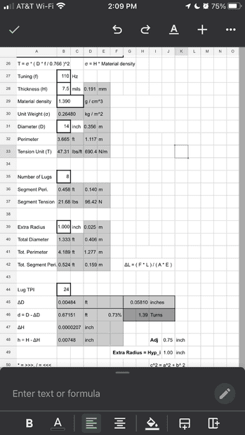

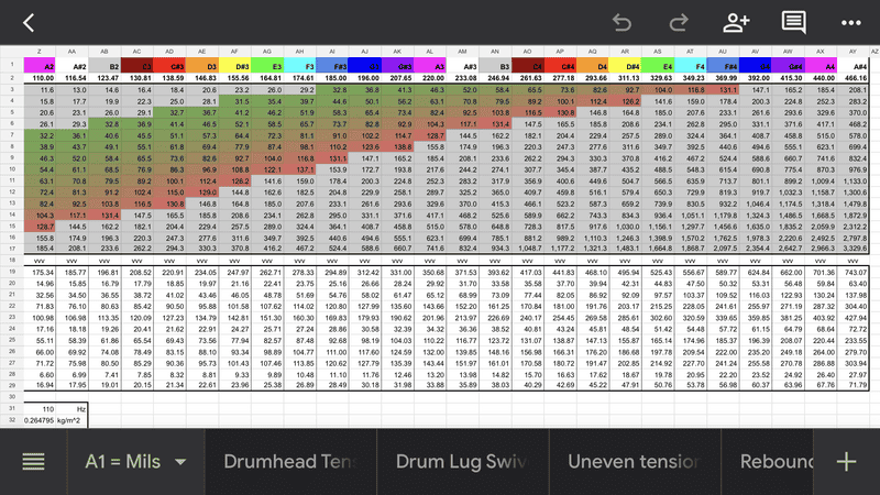

I’m piecing together a Google Sheet which uses it. See attached. (Tension values are in lbs./ft)
Where I’m having trouble is when it comes to predicting the measurable change in overall diameter, not just the ‘speaking’ diameter.
I’m using the equation $$ΔL = \frac{F L_0} {A E}$$, where ΔL = ΔD, F = T, and L_0 = D_0, but is that the correct equation for a circular membrane? I understand that ‘E’ is the modulus of elasticity, but variable ‘A’ has me confused, which is why I’m thinking it’s not. (See attachment ‘IMG_6910’)

Why does “variable ‘A’ [have] me confused”?
I tried setting ‘A’ as the area of the membrane’s overall perimeter, $$A = \frac {π D_0 h} n,$$ where ‘n’ is the number of bolts applying tension to the clamped-edge circular membrane (so that I only get ΔD for one lug instead of two lugs opposite each other), and while it resulted in the correct units of measure the membrane’s height got cancelled out. I’m guessing the reason that formulation doesn’t work out is because, conceptually-speaking, the cross-section I defined probably intersects itself.
If ##\sigma## is the magnitude of the isotropic in-plane stress in the membrane, then $$\sigma=\frac{\Delta D}{D_0}E$$
Wouldn’t the generalized Hooke’s Law $$σ = εE$$ with $$ε = \frac {ΔD} {D_0}$$ get modified when dealing with the specific case of cylindrical coordinates and axisymmetric stress instead of uniaxial, though?

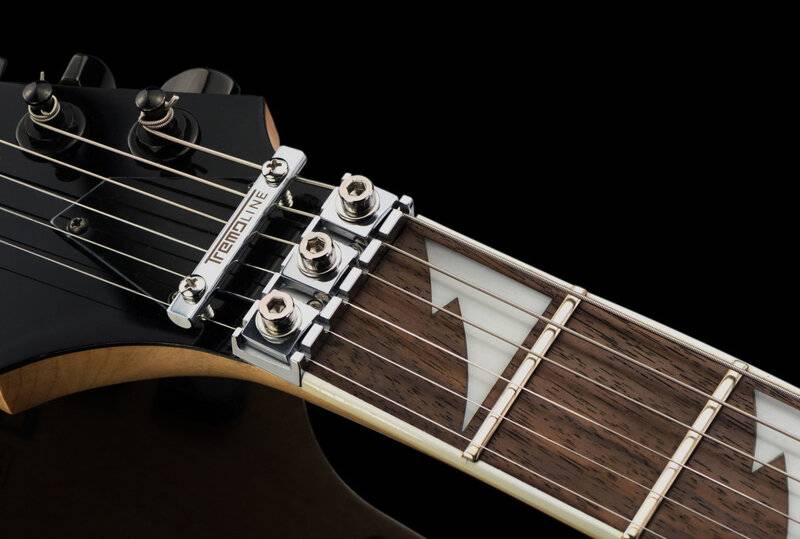

For context, there are electric guitars with something called a ‘locking nut’ up where the tuners are. (See attached.) After all of the strings have been tuned to the desired musical pitches the locking nut’s clamping blocks are tightened down onto the strings so that the strings do not lose their tuning (this is especially common with electric guitars equipped with a ‘double-locking tremolo’, and has to do with ensuring tuning stability across all strings while playing using deep bends across the neck of the instrument or ‘divebombs’, which are notorious for throwing both that string and others out of tune). While clamped, however, the tuners themselves are rendered unusable.
Conventional acoustic drums do not have a locking mechanism other than, say, the bolts (AKA ‘tension rods’) that pull down on the rim, which pulls the drumhead’s collar (clamped to the edge of the drumhead’s skirt) down, which holds tension on the drumhead. The initial tension on the circular membrane is zero, with an initial—unstretched—net diameter of ##D + 2L_{skirt,0}##. (This lacking tension-locking device does allow for other interesting devices to be used in its place, like this! https://www.drumtech.com/dts-drum-tuning-system)
