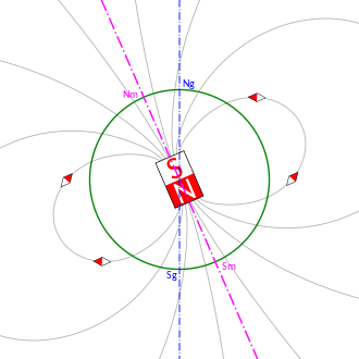

Provided it's a very sensitive compass: the magnetic field there points skywards !
Wiki pic:
compare lower left needle with lower right
Likes davenn and jaumzaum
BvU said:
No. The way you set up your scenario means the needle will rotate 180 degrees when you step over the south pole.
Wiki pic:
Thank you @BvU. Exactly in the magnetic south I am sure it will, but what about a little to the right of it, e.g. in the middle ground of the south-magnetic and north-geographic? I would say the field would have a much higher radial component, but the tangential component there will not be zero, and will make the compass point towards the geographic south, am I right?
I thought that's not in your scenario
jaumzaum said:
magnetized bar with all 4 poles aligned
Did I misinterpret this ? 2 magnetic and 2 geographic is all I could think of.
Yes. The compass points to the magnetic pole. It does not know about the geographic pole.
