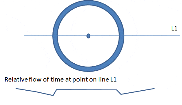

in addition Iam also wondering how the observer somewhere on a line experiences flow of time compared to the far away observer. I assume time flows slower the more the observer comes close to the ring of material, but what happen for the observer inside the ring. I suppose time flows same as for the far away observer as for the observer inside the ring there is no curvature?
here a picture to previous post. and of course how does this behavior evolve in time when the rings contracts to a singularity. up to which moment can you speak of a ring of falling material with nothing in it as the singularity would mean a single point so could where does the situation change over from nothin in it to the 1 point of singularity? or is the situation with nothing in it always remaining but at a continuously reducing scale?
There is no way to compare the two. More precisely, any comparison between the two will depend on choosing a simultaneity convention, and there are an infinite number of different possible conventions you could choose.

not sure if I can follow you. What I mean is that an observer at a certain point ages slower than an observer at infinite distance. so if you bring back the observer from the ring back to infinity you could compare both watches and make a conclusion about the relative flow of time?
Not even if the shell is zero thickness? That should define a unique relationship between the inside and outside planes of simultaneity, no?
You can't. The observer at the center is inside the event horizon, so he can't escape to infinity.
The problem is that when passing through the shell there's no global definition of "time" because it's not a stationary spacetime. You can certainly push someone inside and pull them back out and there's a unique answer to how old they are, but how much of it is attributable to gravitational time dilation and how much to kinematic time dilation is not well defined. You can make cases for different splits (or argue that splitting things up like that is illegitimate on this case), and no one split is picked out by the physics.
I think you can get away with it if the shell is infinitesimally thin, but maybe not - delta function mass distributions are not really physical.

so you could do this comparison at least for certain not too extreme situations? The reason why I ask this is because I would expect time flows the same inside the ring at at infinite distance as there is no curvature inside the ring. so we could at least conclude if this is true for a ring much larger than its event hozizon. Even if the ring crosses its own event horizon there is still no curvature inside the ring, so I would expect from inside the ring it does not make any difference how big the event horizon is. only problen is that the observer cannot get out of the ring then anymore to compare his flow of time with that of infinite distance. but not clear if this makes any difference as curvature inside the ring remains zero?
PeterDonis said:
NThe event horizon initially forms at the center and moves outward until it encounters the shell
but how is that possible when inside the shell there is no matter so no curvature? so how can an event horizon than be inside the shell?
No, this is wrong. With a static shell where time dilation is well defined, the time dilation factor between the interior of the shell and infinity is the same as that at the surface of the shell. This is because time dilation depends on gravitational potential differences, not curvature.
The event horizon is the surface dividing events that can send light signals to infinity (future null infinity, to be pedantic) and those that cannot. An any point within the shell there is a last chance to send signals to infinity, which is the last time you could send a signal that reaches the shell just before it crosses its own Schwarzschild radius. After that, you cannot send signals to infinity; ergo you are within the event horizon.
