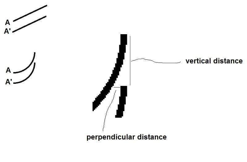

The picture above gives an analogy to Bell's Spaceship Paradox in ordinary geometry.
Draw two curves, A and A', that are identical except one is displaced in the vertical direction.
If the two curves are straight lines, as shown in the upper-left, then they will be parallel. The distance between the two curves is constant.
If the two curves are NOT straight, as shown in the lower-left, then they will not be parallel. The distance between the two curves changes as you move along one of the curves.
How is this possible? On the right, we show a blow-up of the non-straight case. What you can see is that for the two identical curves, the vertical distance between corresponding points on the curve remains constant. But vertical distance is not the relevant notion of distance between two non-straight curves. A more appropriate notion of distance is "perpendicular distance". You take a point on one of the curves, and take a line that is perpendicular to the curve at that point, and you measure the distance between the two curves along that line. The perpendicular distance changes as you move along the curve. For a curve that is horizontal, "vertical distance" and "horizontal distance" are the same. For a curve that is straight, the two are not the same, but they are always proportional. But for a curve that is not straight, the two notions of distance can be very different.
In the Bell Spaceship Paradox, there is a similar thing going on. Instead of "vertical" and "horizontal", you have "spatial distance" and "time" (relative to the original rest frame of the rockets). The two rockets trace out two "curves" in spacetime that are identical, except one is displaced in space relative to the other. The spatial distance between the rockets, as measured in the original rest frame, remains constant. But that is not the relevant notion of distance. A more appropriate notion of distance is the distance between the rockets as measured in the instantaneous rest frame of one of the rockets. This is the analog of "perpendicular distance" in the diagram. This notion of distance changes as the rockets travel.
