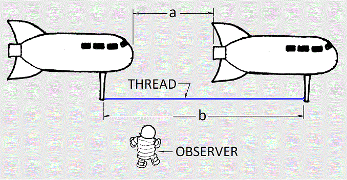

You and two identical spaceships are all at rest with respect to each other. You note that the two engines start up at the same time, and the thrust curve and acceleration profile of both spaceships are identical. As the ships pick up speed, would you measure the ships to be shorter than their rest length?

For him lengths of the rockets are shortened. The distance between the ships are kept constant. The thread which is moving and accelerating is shortened so torn apart.
Of course (with reasonable assumptions about the ship design). But the string's length does not change until it snaps.
A key point is that the thread does not shorten. In the original rest frame of the ships you said it yourself: The distance between the ships are kept constant. So the thread does not shorten in this frame - it stays the same length. In each successive momentarily comoving inertial frame of the thread (to the extent such a thing can be defined) the spacing between the ships is larger than the moment before, and the thread actually lengthens.
The point you are trying to make, I think, is that the original rest frame of the ships regards the thread as moving. Hence the thread's unstressed length would decrease over time. However, stresses build up and stretch it, countering this effect. The stresses cause the thread to break.

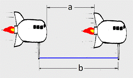

Then I take it you'd measure distance a as remaining the same. Would you measure the length of the thread (b) getting shorter due to length contraction of the ships?
Re:#8 your figure shows that [tex]b-a[/tex] = length of a ship = [tex]l_0\sqrt{1-\frac{v^2}{c^2}}[/tex].
It does not matter whether there is a thread between the ships or not as far as elastic property of thread does not harm designed acceleration of rockets.
No, because the thread is being stretched, which in the frame you are using means its measured length stays the same, instead of contracting as it would if it were not connected to both ships.
Assuming that the ships are of identical design, then in the original rest frame equivalent points will remain at constant separation. The obvious equivalent point is the rocket exhausts on the two ships, since this is the point where the thrust is applied. Since identical ships will react identically to identical thrust, though, the noses will remain at constant separation, as will the attachment pylons for the thread. The nose-to-tail separation of the ships will vary slightly because the length of the ships varies as measured in this frame.
So, on your diagram, and assuming identical ships with identical proper acceleration profiles, and that we're working in the original rest frame of the rocket, (b) remains constant. (a) does not.

pervect said:
It's not clear to me what frame of reference "you" are in. I'm guessing that "you" are in an inertial frame of reference, and that when 'you' (David Lewis) say that both space-ships start up "at the same time", you mean that they start up the same time in said inertial frame of reference.
Correct. "You" is the spaceman depicted in the diagram attached to Post #1. I labeled him "OBSERVER".
