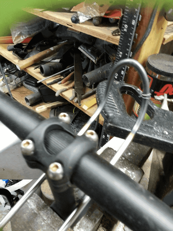

Bending a spring steel rod to shape and heat treat, DIY?

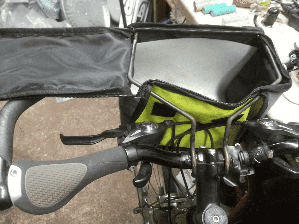

In summary, a style bicycle handlebar bag that used a formed spring steel rod that fit over the handlebars and looped under the handlebar stem that supported a handlebar bag did not appear to be available any longer. The metal rod frame appears to be spring steel and can be squeezed together to form the desired shape, but after it is bent it seems to be heat treated to give it strength and springiness. The rod may need to be heat treated to be compatible with the design of the handlebar bag.
Spinnor
2,226
431
There used to be sold a style bicycle handlebar bags that used what I think is a formed spring steel rod that fit over the handlebars and looped under the handlebar stem that supported a handlebar bag. For whatever reason this style does not appear to be available any more. I think it is a superior design and would like to reproduce roughly the shape seen below. The metal rod frame appears to be spring steel, you can squeeze the ends together a fair amount and it returns to its original shape when you let go. I could easily bend the same size rod to the shape I want if the steel was soft but after it is bent it seems it must be heat treated to give it strength and springiness? Does that seem how the handlebar bag frame below might have been made, form and then heat treat or do you just form the spring steel and you are done? Assuming the frame must be heat treated how difficult would that be? Pictured below is a bag frame that I have bent, sometimes with heat, too many times to fit different bikes and bags.
Thanks for any suggestions on steel type and heat treatment.

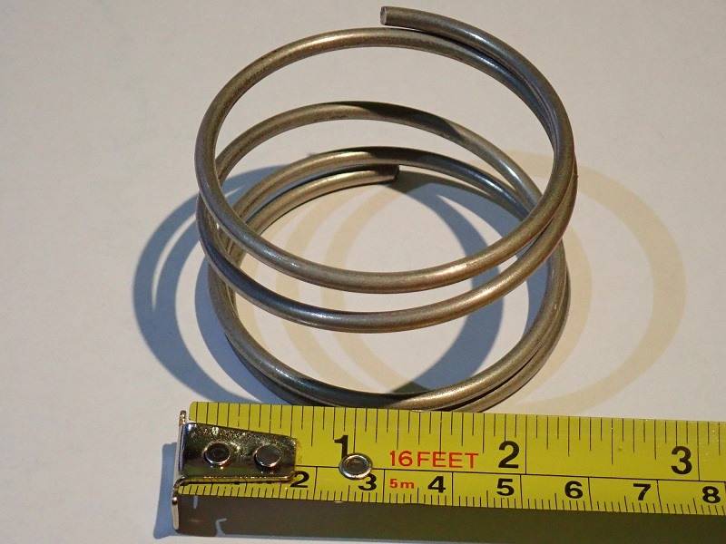

Spring wire up to some size can be bent cold. The photo below is my first attempt at winding a replacement spring for a trash pump mechanical seal:
It was cold wound from 0.125" diameter stainless steel wire. I got the wire from McMaster-Carr: https://www.mcmaster.com/stainless-steel-wire/spring-back-multipurpose-304-stainless-steel-wire/. This wire can be cold bent to a much tighter radius than in the above photo.
Warning: When bending spring wire in these sizes, be careful about releasing tension. If you cut it under tension, you can get an impressive snap back. Ask me how I know this.

My wire frame is almost exactly 1/4 inch in diameter. Unfortunately the McMaster Carr rod in your link only goes up to .162 inches which might be pushing the rods limit.

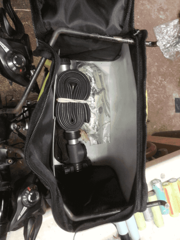

When new the frame supported a bicycle touring bag that could probably hold 8 pounds with ease. I never carry that much, tools a snack, light clothes, phone.
McMaster Carr has a lot of rods! Might this work,
https://www.mcmaster.com/steel-rods/tight-tolerance-multipurpose-oil-hardening-o1-tool-steel-rods/
Sizes above and below .25 inches and in 36 inch lengths and not too expensive.

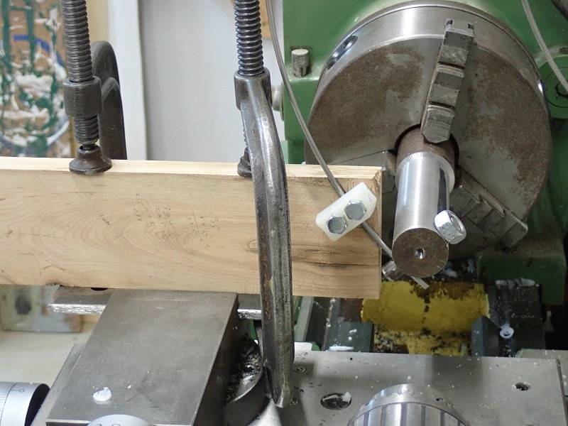

Springs made of 0.125" wire are more challenging than those made from smaller wire. Here's my setup:
The wire is clamped to the mandrel with a cross drilled bolt. Back tension is a UHMW clamp block. The lathe is run at the slowest back gear speed, 60 RPM. Coil pitch is by hand feeding the carriage travel, which is how I got the closed ends on the mechanical seal spring. One hand on the power switch, the other hand on the carriage travel handwheel. And be very careful to remove the tension before cutting the wire.
I would use the power feed for longer springs with 4 or more turns per inch.

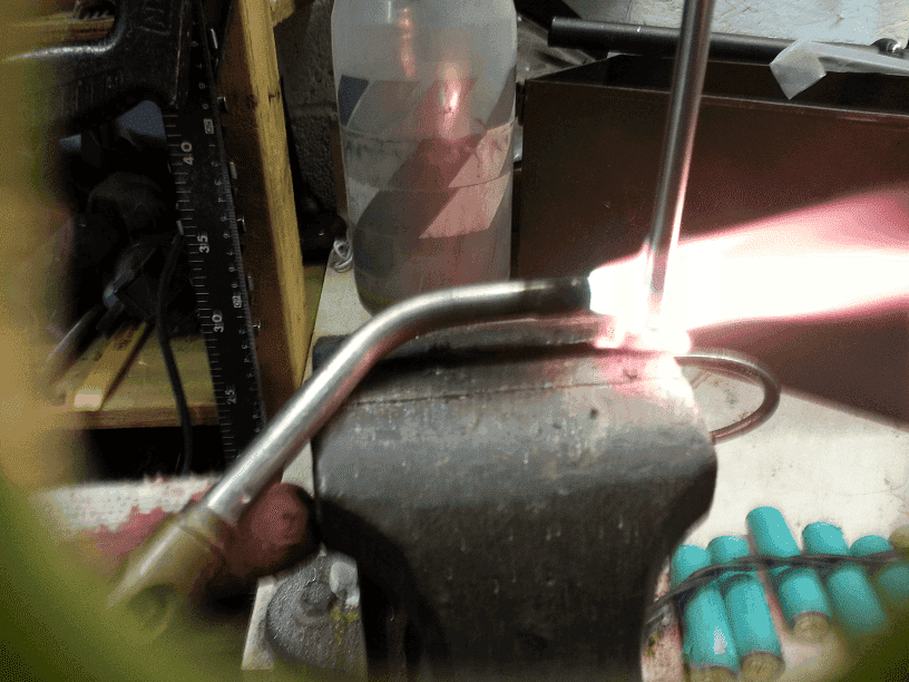

I will be very surprised if you can bend 0.25" O1 rod cold. I've never tried it (on account of me being built like a twig and knowing my limits), but I assume what you get from the McMaster stockroom will be normalized: pretty tough and fairly brittle. If you intend to try it with cold O1 rod, use a vise and pliers not bare hands and protect yourself from flying metal if it breaks.
Overall, I don't think you want to go the O1 route. You are going to have a really hard time bringing that whole shape to critical temperature. Critical temperature is somewhere between red and orange hot (depending on your lighting and the steel). The problem is, if you use a MAP gas torch, by the time you get one 4" segment of the bent rod arrangement to temperature, the rest will have cooled off. If you know a plumber who'd be kind enough to attempt heating it with an oxy-acetylene torch and a rosebud tip, you might have a fighting chance if you also built a shell for it out of bricks to trap heat.

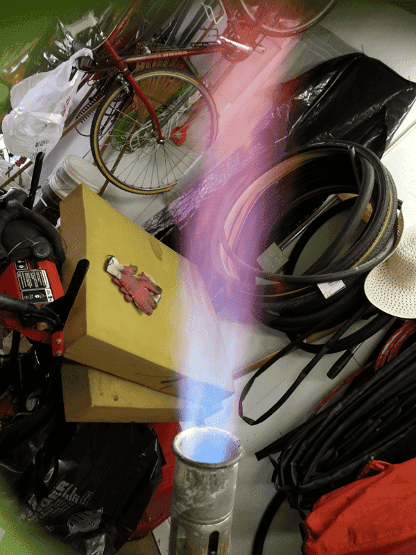

I am guessing that in the manufacturing process of the part I am trying to reproduce it is bent cold and then batch heat treated? I just need the right type of spring steel rod. I have a flame weed eater that produces a lot of heat. Heat treating the rod would be the hardest part of the project but doable with enough precisistance? It looks like after heat treatment the part should also be stress relieved at around 400F for an hour? If the O1 steel was too hard to bend cold it could be heated with another torch I have for bending though I don't know if heating it for bending purposes would affect the properties of the steel with regard to the final heat treatment.
Thanks.

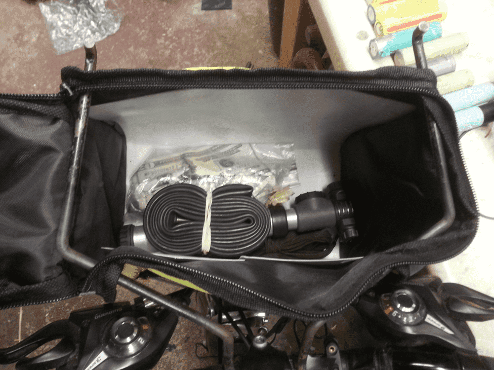

Got some 1/4 inch O1 oil hardening steel rod from McMaster Carr Friday. Sunday I got out the weed eater torch,
With a reference mark in the center of the rod the center 6 inches of the rod were heated and then bent in one motion around a bicycle/stem form,
Minor tweaking of frame was done cold. Further bending was done by heating rod locally with an acetylene torch,

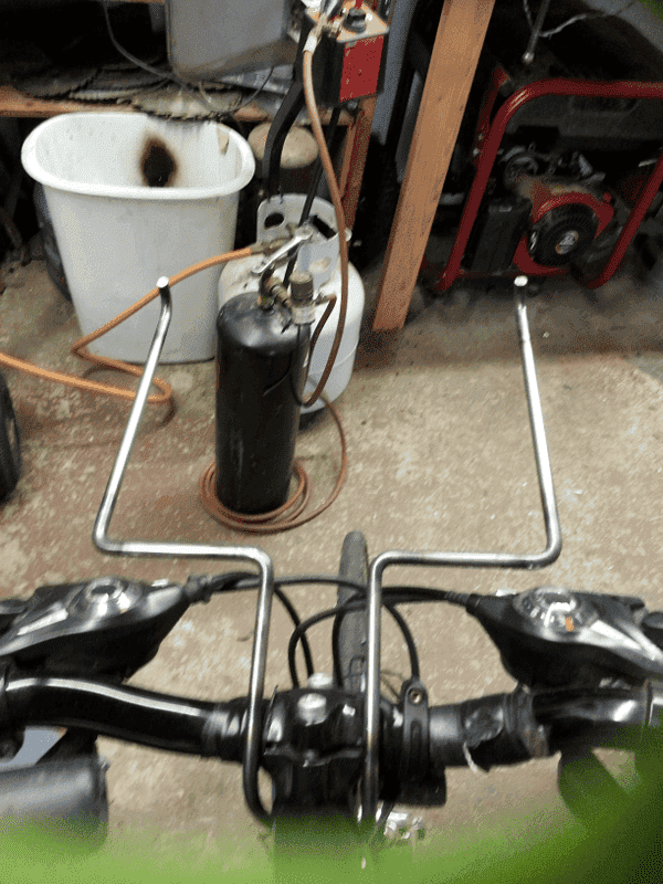

Final product,
Frame seems strong enough for the time being, when bored might try heat treating the frame. If one divides the weight of the frame and bag by its weight capacity (factory made bicycle handle bar bag and frame like the one above) one gets a pretty small number, smaller then any other system I believe. That for me makes it a superior system, safety hazard aside.

Well, I hope you never do a header over the handlebars with that. It could open you up like you had a zipper from sternum to crotch.
Ride safe!
After I paint the frame will wrap enough electrical tape around the ends to reduce the likelihood of that event,
Drive safe!
Rather than only 90°, I would wind between 270° and 360° at the horns
That would reduce the gore liability, and hold a bag more securely.

This frame is for my use only, I am not going into production. If someone were to resurrect this design I concede that my frame as is would need to be made a bit safer.
You are assuming it will not be ridden by a friend, or inherited after your sad demise.
Do you intend the "built in" risk to be a surprise punishment for the thief, or for the naive purchaser of your stolen property?
