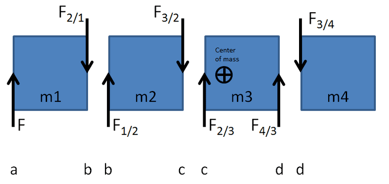

Step4: Draw free body diagram for each sub-rod and solve for all forces
note: a, b, c, and d are the vector distances from an intersection to the com.
Body1: [itex]\tau = Fa - F_{2/1}b=I_1 \alpha[/itex]
[itex]F_{2/1} = \frac{1}{b} (Fa -I_1 \alpha)[/itex]
Body2: [itex]\tau = F_{1/2}b - F_{3/2}c=I_2 \alpha[/itex]
[itex]F_{3/2} = \frac{1}{c} (F_{1/2}b -I_2 \alpha)[/itex]
Body3: [itex]\tau = F_{2/3}c - F_{4/3}d=I_3 \alpha[/itex]
[itex]F_{4/3} = \frac{1}{d} (F_{2/3}b -I_3 \alpha)[/itex] note d<0
Body4: Same as above but no new information is gained.

In your free body diagrams you are missing the internal bending moments.
Also I1, I2, and I3 would also be subjected to the parallel axis theorem.
I would suggest also doing a vertical equilibrium check on each segment to solve for each F segment.

You have the right equation you just omitted the internal bending moment. Whenever you cut a section through a 3-dimensional body it will have 6 internal forces acting on it (assuming x direction is out of the page):
1. Nz = Axial force in z direction = in this case 0
2. Vx = Shear force in x direction = in this case 0
3. Vy = Shear force in y direction = in this case F2/1 as you are showing it correctly
4. Mx = Bending Moment about x-axis = in this case M2/1 which you are missing
5. My = Bending Moment about y-axis = in this case 0
6. Mz = Torque about z axis = in this case 0
And sorry, vertical equilibrium check was a bad choice of words. What I meant to say was:
Sum of forces in y direction (vertical) = m1*a_y
Ok, try this.
Body1 - y forces:
F-F21=m1*a
Body1 - moments about center:
(F+F21)*L1/2 - M21 = I1 *alpha
Body2 - y forces:
F12-F32=m2*a
Body2 - moments about center:
(F12+F32)*L2/2 + M12 - M32 = I2 * alpha
Body3 - y forces:
F23+F43=m3*a (being careful with signs)
Body3 - moments about center:
(F23-F43)*L3/2 + M23 + M43 = I3 * alpha (being careful with signs)
Body4 - y forces:
-F34=m4*a
Body4 - moments about center:
(-F34)*L4/2 - M34 = I4 * alpha
alpha and a are constant across all equations and are solved on the system level (all blocks combined into one).
I1, I2, I3, and I4 are all I=I_cm+mr^2 where r is the distance from the COM of the whole to the middle of each block.
I think I have my signs correct, but would you please check them? I'm particularly concerned about body 3. I believe that the COM being located in body3 causes some signs to flip.
solving for alpha and a:
I_net * alpha = F*r where r is distance from COM to F. gives alpha = F*r/I_net
M*a=F so a=F/M

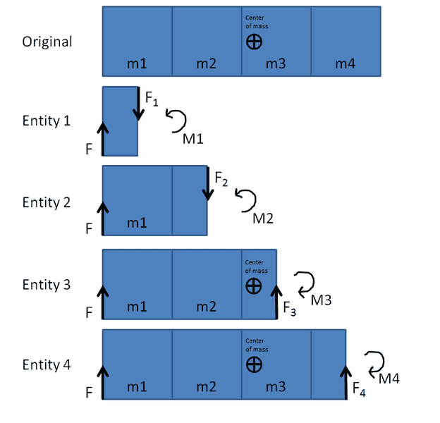

Honestly, I'm primarily interested in the bending moments at the center of each block. Maybe I'm going about this the wrong way. Maybe I need to rethink my FBDs. Instead of the Bodies 1-4 like above, I create Entities 1-4 like so:
Entity 1:
Left half of Body 1. Solve for unknown moment at right side of Entity 1.
Entity 2:
Body 1 and left half of Body 2. Solve for unknown moment at right side of Entity 2.
Entity 3:
Body 1, Body 2, and left half of Body 3. Solve for unknown moment at right side of Entity 3.
Entity 4:
Body 1, Body 2, Body3, and left half of Body 4. Solve for unknown moment at right side of Entity 4.
and M1-4 would provide the moments at the centers of each block?
The only thing I'm a little shaky on is how to define the I for each entity. Body 2, for example, I think it would be: I_cm_1+m_1*r_1^2+I_cm_half2+m_2/2*r_2half^2
where r1 is the distance from the COM to center of body 1, and r2half is the distance from COM to the center of the left half of body 2.
I've made another observation, and now I'm not sure. I'm concerned on Entities 3 and 4 as to whether I can do what I'm showing or not (due to the center of mass). To double check the numbers I have, I setup Entities 3 and 4 from the right side instead of the left, and the numbers I calculated are very different. Any thoughts on what is correct?
When I do my sum of moments = I*alpha, am I restricted as to where I take my moments about? I've been taking them at the same locations as my M1-4 above. Is that ok? Should I be taking the moments about the COM instead? This has been allowing me to ignore my F1-F4 terms in my moment calculations.

The signs don't really matter, just as long as you stay consistent, including for body3. I didn't check all your equations but they looked alright to me.
Not sure why you want the moments at the center of the block. I would suggest get the moments at the body intersections and then interpolate.

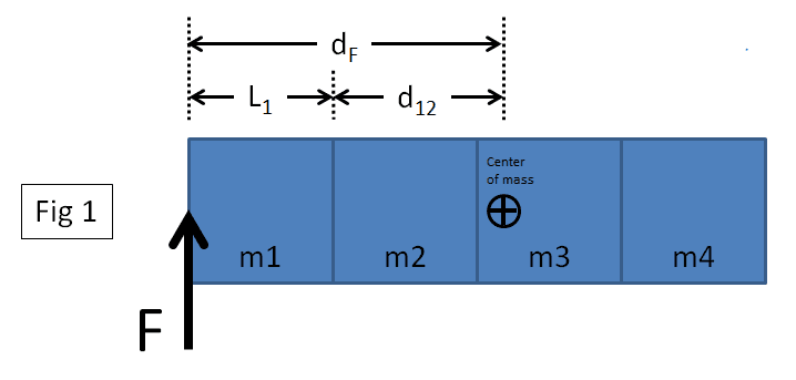

Unfortunately, I'm still stuck. I've tried solving this problem several of the ways previously discussed, but I get answers that don't make sense and don't match. I'm going to rehash the startup and show where I'm stuck, and hopefully someone can provide some insight.
Fig 1 below shows the same 4 blocks fused end to end. A force F is applied to the left-most side of block 1, and the system rotates about the center of mass (I'm assuming).
Starting from diagram (a), I setup my equations and solve for [itex]\alpha[/itex] and [itex]a_y[/itex].
1. [itex]\sum F_y=F=m_{net} a_y[/itex] where [itex]m_{net} = \sum m_i [/itex]
This provides [itex]a_y=F/m_{net}[/itex].
2. [itex]\sum M[/itex](about the COM) [itex]=F d_{F}=I_{net} \alpha[/itex] where [itex]I_{net}[/itex] is the combined moment of inertia of all blocks.
This provides [itex]\alpha = \frac{F}{d_F}[/itex]

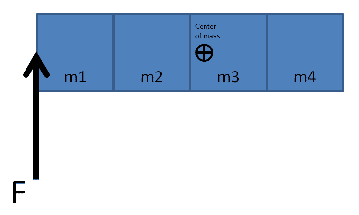

Now that I have [itex]\alpha[/itex] and [itex]a_y[/itex], I want to solve for the moment at the 1-2 interface. To do this, I limit my FBD to only block 1 (shown in Fig 2) and write the following questions:
3. [itex]\sum F_y=F-F_{21}=m_1 a_y[/itex], and I can solve this equation for [itex]F_{21}[/itex].
4. [itex]\sum M[/itex](about ?) [itex]=F d_{?} + F_{21} d_{??} + M_{21}=I_{??} \alpha[/itex]
Obviously, I'm uncertain about a number things about equation 4.
a. In statics, I can take the sum of moments about any point because it must equal = 0. Is this still the case for dynamics? This will tell me [itex]d_{?}[/itex] and [itex]d_{??}[/itex].
b. Is the moment of inertia used in this equation [itex]I_1[/itex]? And if so, does [itex]I_1[/itex] include the offset I from the total body's center of mass (parallel axis theorem)?
c. Am I including all of the right terms? The right signs?
d. Because F is applied to the end, is [itex]|a_y|>0[/itex]?
