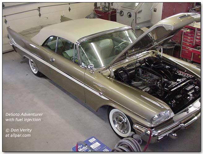

You'll enjoy this article
http://www.allpar.com/cars/desoto/electrojector.html
it has a good rundown on the differences.
It's really written about this car,
the one 1958 Desoto left on the planet with its analog electronic fuel injection system intact.

Yeah, Chrysler got tired of all the maintenance and warranty headaches with this system, IIRC, and developed a dealer-installed kit to convert the injection cars back to regular carburetion. Most owners took advantage of the swap, and with DeSoto being dropped soon after by Chrysler, time has taken care of the rest of these cars, save one.
The competing fully mechanical system developed by GM about the same time had somewhat more success. At first, it was available in selected models of full size cars along with sportier lines like Corvette, but its use eventually dwindled down to just that last model until 1965, when it was dropped for big block engines and multi-carb setups which were then proliferating. Still, surviving cars equipped with this FI system are rare today and highly prized by collectors. A second hand FI system in good condition can fetch upwards of $10,000-$15,000 alone today, with a few original new old stock (NOS) units still out there, commanding the highest prices.

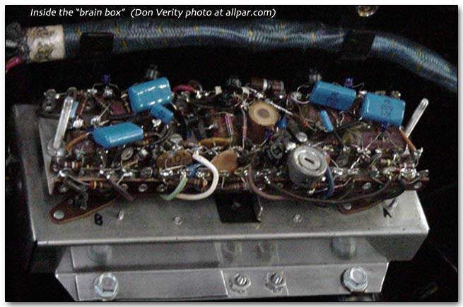

1957 ? Doubtless it was germanium transistors... Although the February 2003 IEEE Spectrum wrote an article describing it as vacuum tubes, i see no tube sockets in the photos. Can you imagine such an analog computer in automotive temperature environment?
Looks like a pair of transistor sockets underneath the circuit board.
Reports are it wouldn't start below 40degF..
I think the electronic control unit on the Bendix/Chrysler Electrojector EFI was built from discrete components, since this system pre-dated the invention of integrated circuits as we know them today.
According to this SAE paper from 1957, written on the development of the Electrojector system, p. 760 in the available preview,
http://papers.sae.org/570060/
Bendix engineers first prototyped the ECU using vacuum tubes, but they soon found that tubes take a while to warm up before they can function. The production ECUs were re-designed to use transistors in place of vacuum tubes, hence their absence from the photo of the innards of the ECU. Tubes also required a relatively high current draw from the battery while the system warmed up. Apparently, the development of the ECU resulted in at least 4 different models, including the tube prototype, with each succeeding model getting smaller and drawing less current for operation.
Likes jim hardy
