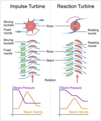

There are two sets of blades, one rotor static, one stator static. How is that reflected in your analysis?

Flow around a turbine is also not inviscid, nor can it be readily approximated as such. Have you considered the derivation of Bernoulli's equation from the integral conservation of energy equation? It may be more clear there.
Thanks, I agree that in the real world, flow around a turbine is not inviscid. Hence, the Euler's equation and the Bernoulli equation will provide incorrect results. And so, we use the integral conservation of energy in such cases.
Many books say that even if the flow in the turbine were inviscid, the Bernoulli equation would not hold true. Some of them explain it by saying that such devices destroy the streamlines (I don't know what this means) while others say that it is because Euler's equation does not take account of shaft work (Again, how can a momentum balance equation take account of work of any kind?). I have never seen sense in these reasons.
The purpose of my last post was to explain that even if flow through a pump or turbine were inviscid, Bernoulli equation would not be valid only because of the unsteady nature of the flow through these devices and not because of the reasons that many of the books provide.
I'll ask again. Have you looked at the derivation of Bernoulli's equation via the integral energy conservation equation.
Yes, I have looked at the derivation using the integral energy conservation.
