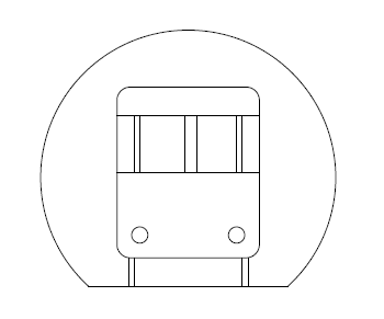

The train is traveling in a gallery at ##v=70 km/h##. Outside air is not moving and pressure is ##p_0=101325 Pa## and temperature ##T=283 K ##. The area of the face of the train is ##A=9 m^2##. Determine the minimum area of the section of the gallery such that the pressure inside the train does not go down ##P=90000Pa##
Bernoulli equation
I cannot really relate the Surface of the sections of train or the gallery with the pressure difference, what is the relation that one should use?
This looks very much like a fluid that moves through a constriction, that is the air in the tunnel (gallery) has to flow through a smaller area when the train passes, which would reduce its pressure as the train passes.
Likes NascentOxygen and Soren4
Thanks for the reply! Didn't think about that! But in the problem is the pressure inside the train that goes down.. I'm quite confused about which of the two masses of air is moving (the one in the train or the one in the gallery). In the text it is said that the air outside the train is steady..
Surely it will move when the train passes! It has to flow over the oncoming train to make room for it. The same process happens when an aeroplane moves through the air. The air flows over the plane and especially it's wings. What is moving the air or the aeroplane? A passenger will say that the air is moving past the aeroplane, while an air molecule will say that the aeroplane is moving past it. All motion is relative. The pressure of the moving air will decrease and thereby decrease the pressure in the train, unless it is sealed perfectly like an aeroplane (in which the pressure is regulated). The same happens in a car as anyone with sinus problems (like me :wink:) will tell you. Long trips can really sometimes reak havoc and cause problems due to the reduced pressure and my system not being able to equalize.

I am not following your reasoning there, so do not see the difficulty. As andrevdh posted, you can consider it in the reference frame of the train. (The only doubt is that the walls of the tunnel are also moving relative to the train.)
It does not change which will be the high pressures and which will be low.

The stated premise is that outside air is not moving with respect to the ground (gallery), which would eliminate issues related to drag (which would violate Bernoulli). The implied premise is that the outside air is not moving (with respect to the ground) must be referring only to the air in front of and behind the train (zero drag). If the outside air was not moving along the sides of the train, then there's no change in speed, just compression of the air. Another implied premise is that the pressure of the air inside the train is the same as the pressure of the air along the sides of the train, even though the air inside the train moves at a different velocity than the air outside the train, (this would be possible if the venting of the train involved the equivalent of static ports).
As already posted above, the desired approach is to use the trains frame of reference and consider the air to speed up along the sides of the train in the same manner as a constricted flow. From a ground based frame, the air would travel backwards along the sides of the train.

Thanks a lot for the reply to my question! I thought about it again but still I do not see how can be no difference in the pressure from the frame of reference chosen. I considered the two possible frame of reference:
  • Frame of reference of the train: ##v_{air \, inside \, the \, train}=0 km/h## and ##v_{air \, outside \, the \, train}=70 km/h## ##\implies## ##p_{\, outside \, the \, train}=p_{atm}-\frac{1}{2} \rho v_{air \, outside \, the \, train}^2## and ##p_{\, inside \, the \, train}=p_{atm}##
  • Frame of reference of the gallery: ##v_{air \, inside \, the \, train}=70 km/h## and##v_{air \, outside \, the \, train}=0 km/h## ##\implies## ##p_{\, inside \, the \, train}=p_{atm}-\frac{1}{2} \rho v_{air \, inside \, the \, train}^2## and ##p_{\, outside \, the \, train}=p_{atm}##
That's how the velocity changes the pressure, as far as I could understand about Bernoulli equation. Did I get it completely wrong?

It appears that you're supposed to assume the static pressure of the air inside the train is the same as the static pressure of the air outside the side of the train (not the front or the back), despite the differences in velocity. This could be possible if the trains ventilation was the effective equivalent of static ports, which are not sensitive to differences between internal and external velocities (as long as the speeds are reasonably below mach 1).
Say the cross sectional area of the gallery (tunnel) is 18 m2, then from the trains frame of reference the air's velocity increases from 70 km/h to 140 km/h as it moves around the train. From the ground frame of reference, I would assume that the air travels backwards at 70 km/h (same 70 km/h difference in speed), however the calculated pressure of the air along the sides of the train will differ, depending on the frame of reference. The issue here is that the velocity related component of energy or in this case, the energy per unit volume of air relative to velocity or a change in velocity is frame dependent, and it's not clear which frame of reference that the problem wants you to use.
In the real world, the static pressure of the air around the train would be independent of frame, but the problem ignores factors like drag, which violates Bernoulli. If drag is included, then from both frames of reference, the air is accelerated forwards, increasing its velocity (from zero to non-zero) from a ground frame of reference, and decreasing it's velocity (from 70 km/h to something less) from the trains frame of reference.
