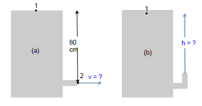

Use Bernoulli’s equation to calculate how fast the water emerges from the open tap (at position 2) in the figure(a). You may assume that the water at position 1 moves negligibly slowly
(b) The tap is rotated to create a fountain as shown in (b) Calculate the maximum height h that
the water could reach
Bernoulli's equation
Im looking to answer question b, I'm pretty sure I've done part A right.
So for B what I did was since I got v from part a which was 3.96, hence I did follow on the part from part a, that is= rho h1= 1/2 v^2 changing to solve for h, then I got h as 1.25 meters. Idk If i did part b right.

Looks good based on what I can see ... I'll give you a conditional thumb's up. Haven't actually "crunched" the square root.
The image shows the tank's total height to be 80 cm. That's 0.80 m. How can the water from the "fountain" exceed that height? Sounds like a magnificent start for an over unity machine o_O

I concur with gneill. Bernoulli will predict the height will be the same 80 cm as in the tank.

It's not intuitive. It's just straight application of the Bernoulli equation. It even gives the same result in the second part as just taking an initial upward velocity of ##v_0##, and applying ##v_f^2 = v_0^2-2gz##.

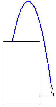

There's no reason why the nozzle of the outlet couldn't be angled a tad to allow the stream to form a parabolic arc that ended up over the tank. The tank height is only 80 cm above the nozzle, and some have predicted that the stream could reach 1.25 meters in height if directed straight up. Then:
... and the lateral motion comes from where?
It's just projectile motion. A bit of the vy is "stolen" to allow some vx. Apparently we have height to spare!

Hi i got 0.8 meters, is it right?
You're going to have to give us the entire problem statement.
Yes, that would be my conclusion.
Yes. This is the same thing as shooting a water hose into the air.

I have to say that I agree with @gneill and @Chestermiller here. You will only get an energy density at the bottom of the tank that is equivalent to the hydrostatic pressure from the depth of the water, which is then converted entirely to velocity in the outlet. That kinetic energy at the outlet is then converted back into potential energy as it travels upward. Essentially, you are saying that it starts with hydrostatic pressure (potential energy) ##\rho g h_1##, which is then converted to kinetic energy (dynamic pressure) ##\frac{1}{2}\rho v^2##, and that is then converted back to potential energy ##\rho g h_2##. If there are no losses, then that simply predicts that ##h_1 = h_2## and the heights are equal. Of course the real world has losses, but problems like this are typically assigned with the assumption of no losses in the flow as an illustration of energy conservation.
This also assumes the tank is sufficiently large as to be considered static inside. If the flow has some initial velocity, then that is an added source of kinetic energy, so you should, in theory, be able to squirt higher than the original surface.
