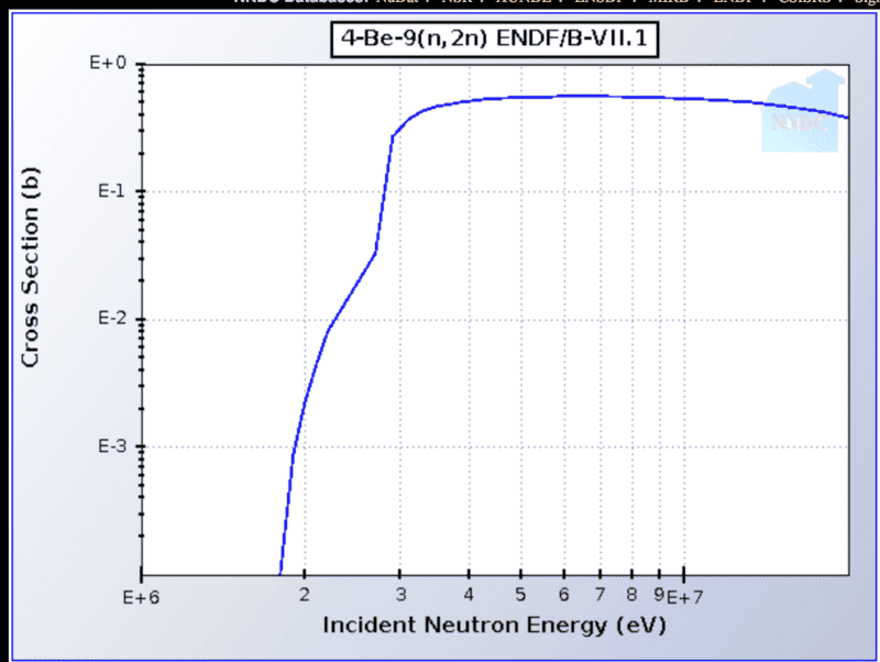

Beryllium gives off 2 neutrons if hit by a neutron that has on average more than 1.9 MeV and also produces neutrons when bombarded with alpha emission. Both cases are present in a reactor core, alpha emission from fission isotope decay and all neutrons being born as fast.

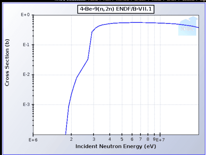

The 1.9 MeV value represents a threshold energy of the fast neutron for the (n,2n) reaction, so one doesn't gain 2 neutrons, only one, since the incident neutron is replaced by 2n. The cross-section at 1.9 MeV is very low, ~ 1E-4 b, but increases to about 0.3 b at 3 MeV and to 0.6 b at 6 MeV, which is still fairly low. See attached figure. But then one must consider that the fast neutron population falls for energy > ~ 1 MeV.
Well a neutron goes in,capture happens the nucleus splits into 2 alphas +2n which are free to fly off is what I understand but it seems that is not the only reaction that can happen with Be9+n so one would need to look at reaction rates for each of them.
