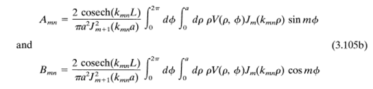

I'm not sure which edition of Jackson you have. For the 3rd edition see section 3.8, pages 117 and 118. You should be able to use equations (3.105a) and (3.105b) to determine the potential inside the cylinder. In your problem, the potential does not depend on ##\phi##. So, only one value of the index ##m## in (3.105a) contributes.
It turns out that I don't know much about Bessel function. Thank you, sir.
