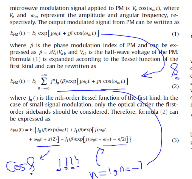

In summary, the conversation is about a transformation from exponential to Bessel function and has two questions. The first question is about the disappearance of cosine in the third equation and the second question is about the transformation process itself. The answer to the second question can be found in the Wikipedia page for Jacobi-Anger expansion, and the person also notes that there may be an error in equation 2.

In a article I have found this transformation (exp to bessel function) . I have two questions.
a)where did the Cos go after setting n=1 and n=-1 ? in the third equations ( it is equal to -wmt-pi/2)? why?)
b)how did the writer transform the exp to bessel function?
Thanks[/B]
