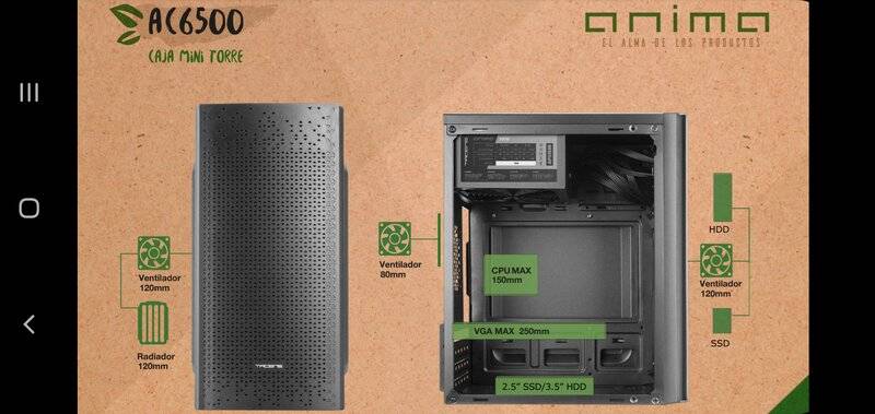

This is the case i'm going to use

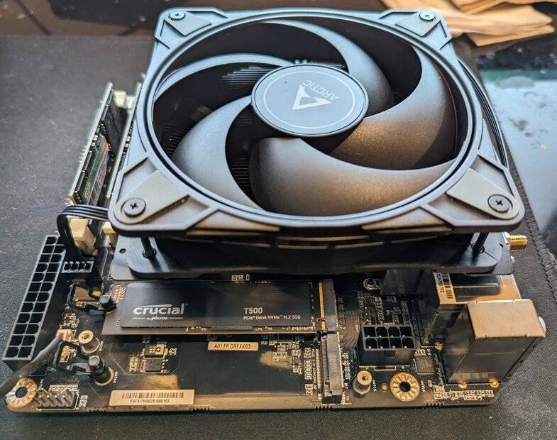

I don't understand radiator/fan for side of case, but my idea is to use two arctic p12 max and one arctic p8 max fans for case. One arctic p12 max for cpu. All of them are high static pressure fans.

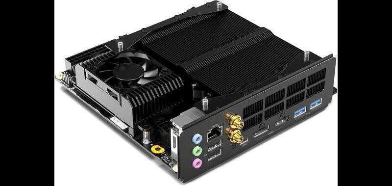

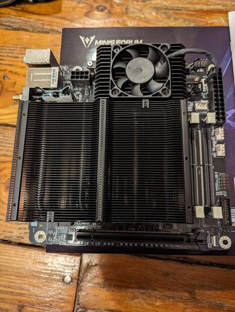

Motherboard with heatshink is bd790i:

Best configuration for me is case upright. Side and front fans pushing air inside, back fan (80mm fan) draws air from inside to outside. Cpu fan blowing towards heatsink.
Secondary configuration that might work well for me could be. Case horizontally placedwith side fan at top. Side fan blowing air to outside. Front and back fans pushing air inward. Cpu fan pulling air through heatsink.

General suggestions:
* Try to blow air directing its flow in a direction aligned (parallel) with the cooling fins.
* Blow in as much volume of air as you suck out in order to make airflow sweeping the interior cross-section of the case as high as possible.
* Heated air tends to ascend; therefore, place sucking fans as high as possible (consider that those do not induce airflows reaching heat sources nearby their inlets).
* Consider filtering intake air to reduce dust deposits inside the case.
