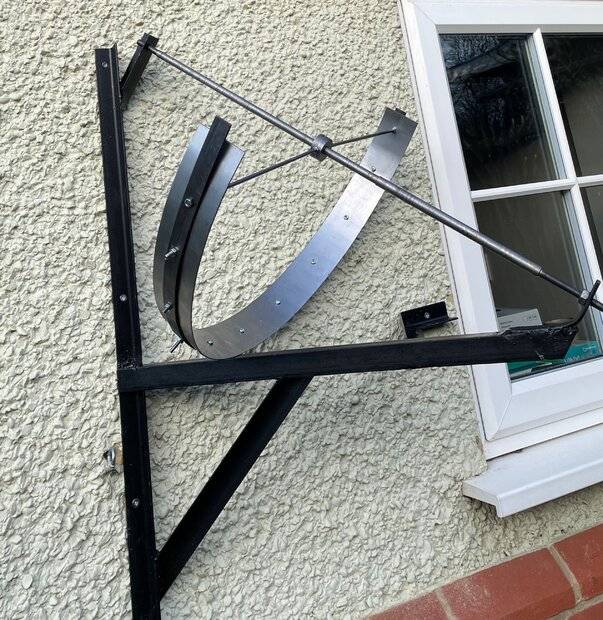

I am making a sundial, based on an armillary. The image shows the principle and it's fixed to a sunny wall; it's only half finished as yet. The bar is aligned with the polar axis and the arc with the horizontal plane. I have omitted the higher parts of the arc so it doesn't get in the way around the equinox. That bit isn't functional of course but it would adds strength. The bar is the gnomon and throws a shadow on the arc (a nice straight line).
I intend to make the angle of the arc adjustable to compensate for the Equation of Time, using a calibration graph.
It certainly works but I want to optimise the visibility / contrast of the shadow. Given time, I could improve, step by step but it could involve a lot of spray paint cans.
So I'm torn between white and silver and between matt, silk and gloss. (Gloss is not really a starter I think because I don't want a mirror image of the gnomon). That wide reflective band could produce extra light which could fill the shadow. I expect some lenticular design could give the best result but that's too hard guv.
So what should I go for, do you think? I can't afford gold leaf.
