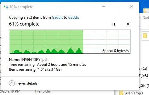

It's really funny we hardware people gone through hell speeding up the hardware and the programmer keep saying speed is NOT the problem and keep adding "sophisticate" crap and say it's NOT a problem. I just checked, USB 3.0 is over 1GB/S, and it's getting slower and slower writing and reading from flash drive.
No wonder the stuffs are getting slower and slower as the hardware gets faster and faster.
  • #32
That is the same as saying "my tires are rated at 130 mph, but it still takes me 3 minutes to get to the grocery store and it's only a mile away!"

No, it's like we give you a sports car and it takes you 30 minutes to the store instead! You are taking it for joy ride instead of driving directly from point A to B in the name of "sophistication" and "elegance".Case in point, I am copying my C++ files into a USB flash drive, it's been running for over 2 hours already, only 61%, still estimate another 2hours. Look at the speed.
Also, how the hell the programs in 4 chapters can be 5GB is size from VS? Those are all example short programs.
  • #35
There must be a lot of "baggage" in a Visual Studio project. Here are the various versions of my three-vector program:
