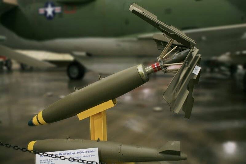

So, a little bit of a follow-up, more to answer the question initially asked... There's a few ways to encourage the rocket to rapidly decelerate in a controlled manner, several of which have seen use by the military for low-altitude, high-speed bomb delivery. The deployable airbrakes mentioned by Baluncore early on is a particularly well-known example, best demonstrated by the Snakeye tail kit for the Mk80 family of low-drag general purpose bombs:
Image from dcsworld.pro
Image from NMUSAF Cold War Gallery
The bomb has four petals that are restrained at the forward end by a strap, to which a lanyard is attached. Depending on the fusing option selected by the pilot, that lanyard is either allowed to depart with the bomb, leaving it in a closed, low-drag mode, or retained briefly to pull the strap off the bomb after it clears the aircraft, allowing the petals to deploy into their high-drag configuration.
The core tubular structure provides an easy place to park a motor, especially a long, thin motor, making it somewhat more approachable for hobbyists.

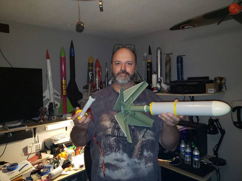

At least one model rocket enthusiast has successfully taken this concept and applied it to rockets, albeit as a recovery mechanism, where the loads are lowest.
There's a nice breakdown of the system in this article from Apogee Rockets. But again, emphasis on deploying it at low speeds to minimize structural loads on the linkages.

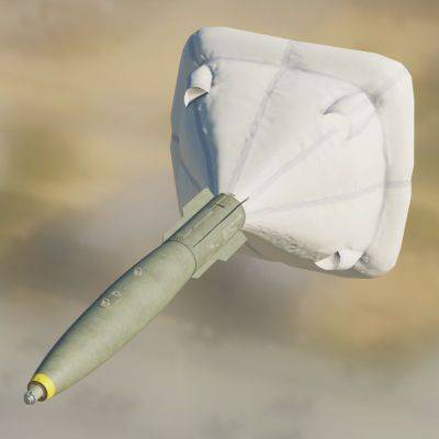

Image from Wikipedia
This is a ballute (combination of balloon and parachute), and it's actually well suited for very high speed (transsonic at sea level to low supersonic at altitude) deployment, conditions that would tear apart the mechanical petal brake designs. It uses a small gas generator charge, not unlike an airbag initiator, to provide initial ejection and inflation, before the air scoops built into the ballute continue to provide inflation pressure.
Note that the ballute approach requires an unobstructed exit to the rear to allow deployment, and the relatively large diameter of the casing that it's deployed from. If you use this with a rocket, you'll need to do some weird work with the rocket motor to get it to fire without burning through the ballute housing. Either a reversed motor with exhaust reversing ducts, or splitting the flow between several nozzles to exit just ahead of the ballute housing. Both options pose significant challenges for manufacturing.

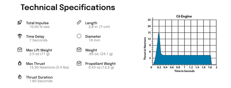

The altitude goal is we lose one point for every foot we go over 790 feet, so this is why I am asking and for the time limit the faster we can start going back down the better because we have to up and down within 44 seconds.
Vanadium 50 said:
They run until empty.
You can, however, select how long they run when you buy them. This is one reason I advised the OP to fly a lot of rockets,
I have been flying Estes rocket kits so I have been using mostly C6-5s with the Riptide rocket kit.

Anyway, if you want less altitude, a sudden stop is bad for the egg. Better to use a smaller engine. One could also add weight.
So, what is the variation in height for "identical" launches? Seems you would want to know that.
